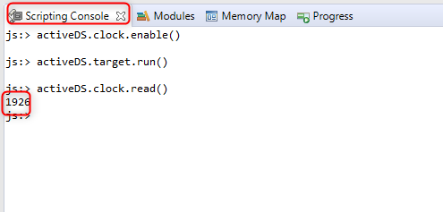

  • So how exactly do I get the cycle count?
  • Via scripting console, see the example below:
    The first line enables the profile clock
    The second line runs the target to a breakpoint I set earlier
    The third line reads the profile clock and returns the cycle count from the time I ran the target to when it hit the breakpoint (1926 cycles)
