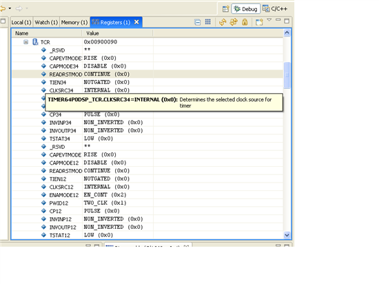

  • This is supported in CCS. I don't have an A8 board available at the moment, but here's a screenshot from a register view on a C674 part. When you are viewing the registers, if you click on the the "+" next to the register name, it expands to show you the bitfield view. If you hover over a field, it will give more info. Also, if you want to change the field, click on the value and if the field has an enumerated set or list of values will be available to choose from with nice descriptive names.

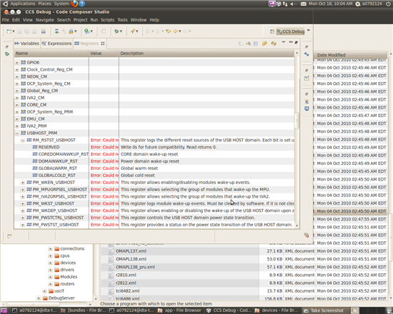

  • Kevin,
    Which board/configuration are you using? I created an OMAP3530 configuration and I have many registers groups for various peripherals. CCSv5 does not have drop down selection for configuring individual bitfields with meaningful names (e.g. Enable/disable drop down). However, it does have description on all registers and bitfields. see screen capture below(I have A8 selected in debug view and I maximized register view to show more information)
    I am using omap3530/Beagle.
    I also see the description of all registers and bitfields, but what I am looking for is the configuring of individual bitfields with meaningful names.

    Sorry - I messed up. I mistakenly fired up CCS4.2 instead of CCS5 (hey - it was late on Friday :). I do see that the descriptions have moved into a column instead of hover-help, so the descriptions are there, but like Martin said, there is not support for the "directed" entry of  individual bitfields like in CCS4.2. Hopefully, that's coming soon, Martin? My guess is that this is one of the drawbacks of moving to "stock" Eclipse in CCS5 - CDT does not have as good a register view as the TI version does in 4.2.
    Mark
  • You are correct Mark. In 4.2 we had our own custom register window that had these features. In v5 we are using stock eclipse's register view that does not have these features. It is something that we will be looking to contribute and enable.
