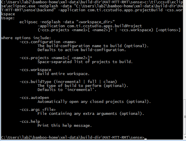

I am trying to build a project (for the C5515) from the command line, using CCS7 or CCS8. However, it only seems to print out the help-test no matter what I do.
I am pretty sure that all the paths are correct. Is there anything I can do to get additional debug information, in order to fix this problem?
thanks
In additional to Rafael's suggestions also take a look at this thread. If you are using Windows Powershell to run the command, that could be the issue.
Hi, I see you passed in "-css.workspace" when it should be "-ccs.workspace"
