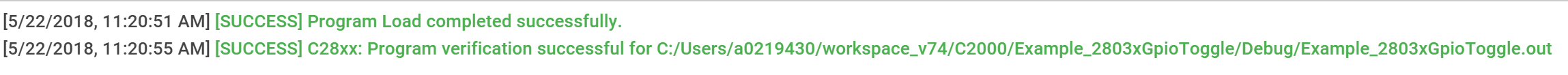

Hi Champs,
I used uniflash v4.2 to program F28035. My flash setting is erase/progeam/verify . I enabled GUI logging and GUI showed "[SUCCESS] Program Load completed successfully." after I click "load image". But it didn't show verification successfully. I clicked ""verify image" and it showed "C28xx: Program verification successful for C:/Users/a0219430/workspace_v74/C2000/Example_2803xGpioToggle/Debug/Example_2803xGpioToggle.out"
Could you please tell me does uniflash really execute verifying during load image process? If yes, can we output log on uniflash console ? thanks.

    Please let me clarify my question. My question is when i click on load image. It should do " Erase,program,verify" due to my setting. However, when i click on "load image", console only show "program load complete successfully". It didn't show " verification successfully" I need to click on " verify image" and it will show verification successfully. I would like to know will uniflash do verification during load image ? Or it only did erase / program ? Thank you.
    Ah, I see now. Please apologize for misunderstanding your initial assertive. The successful program load message is printed after all the procedures stated by the option are successfully completed: in this case, after it successfully erased, programmed and verified.
    Rafael
  • Hi Rafel,
    I see. That means console didn't show verification successfully but uniflash already did verification. If i misunderstand your meaning, please let me know. thanks!
  • Lisa,
    You are correct.
    Rafael
