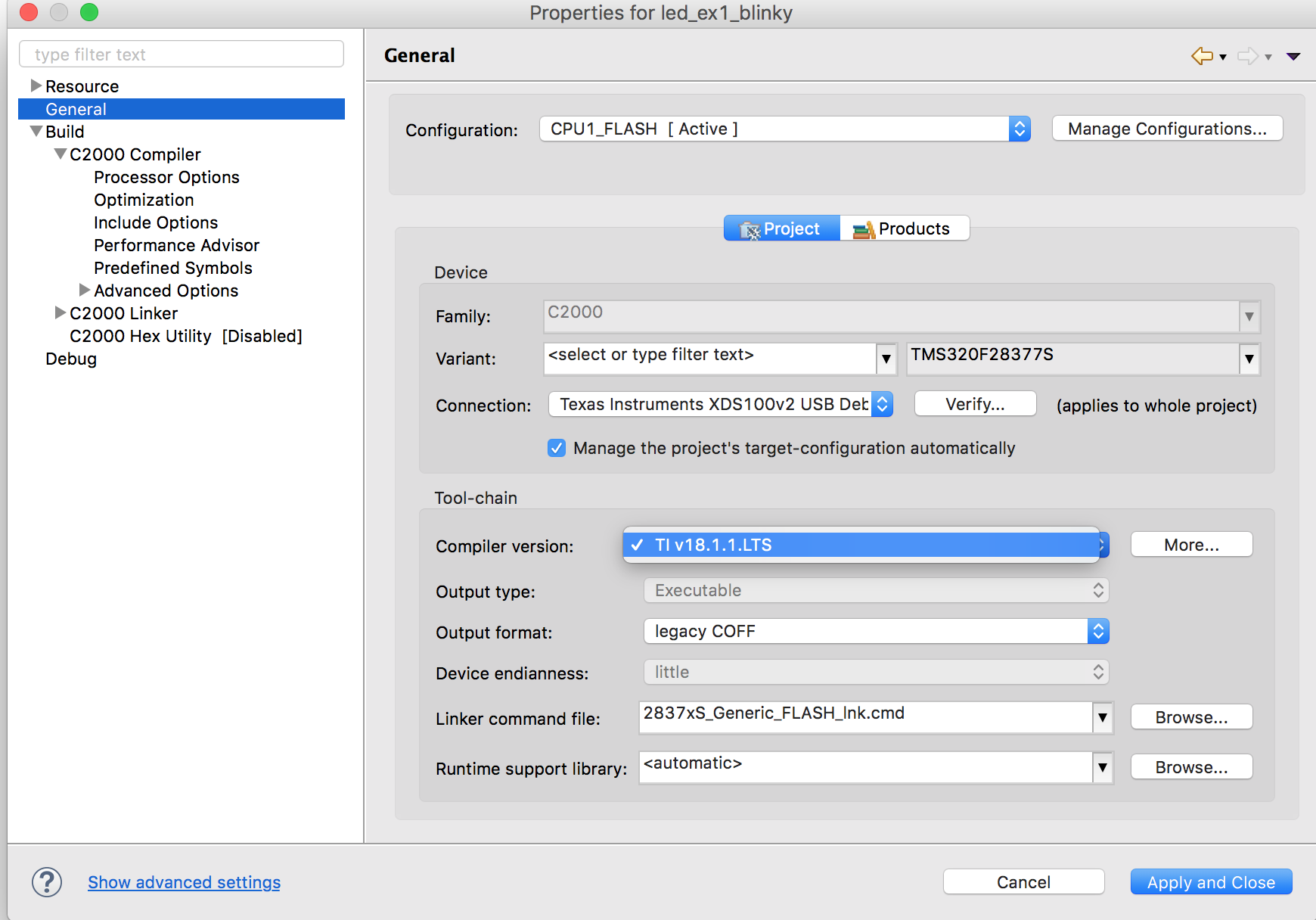

    First lets try configuring your project in 8.0 to use the 16.9.6 compiler from CCSv7.4.
    To do that you can go into the preferences dialog and using the settings below you can add the path to the 16.9.6 compiler and CCS will discover it.  Note that the compiler would be in something like ccsv7/ccs_base/tools/compiler/
    Once that is done you can change the project to use the compiler by changing the properties of the project here:
    Once that is done build and try to debug the project.  If this works then we know there is something going on with the new compiler that is triggering the issue.  If it is not working then we have something else to try.
