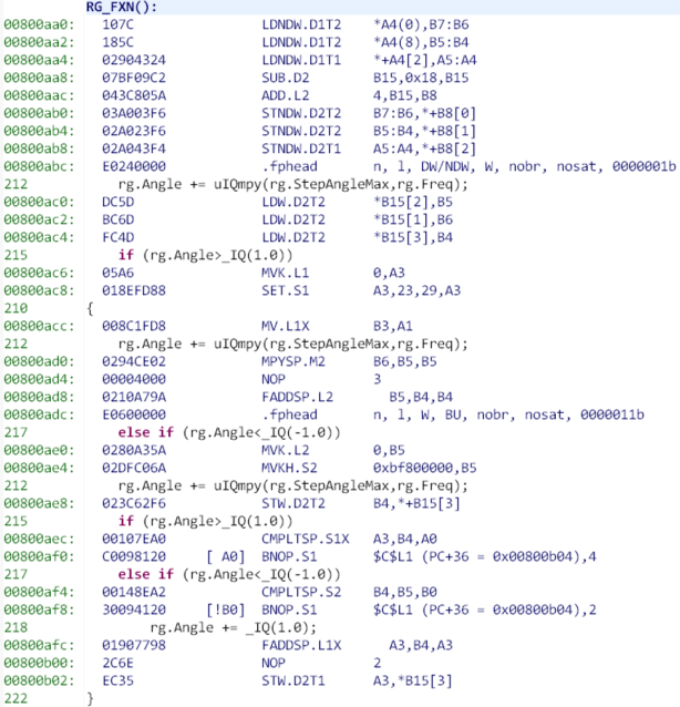

If I compiler this with the following compiler setting of -O3, the output of the function is BNOP.S2 B3, 5 . Could you explain why the compiler shows this behavior.
Additional data point, if I build the code with O1, then the compiler generates the assembly code as shown here:
I would like to confirm that this is the expected behavior ? and if there is some way to avoid the compiler from optimizing the function out of the code in this manner.

  • Is RAMPGEN a pointer? If not, the function is getting a local copy of rg, and therefore there are no affects outside of the function.
  • Keith,
    I think you have nailed the root cause here. The code that I am trying to port has RG_FXN defined two ways: it is defined as a function macro when the full algorithm is bench marked but defined as a function when individual components need to be bench marked probably so that the symbol is generated for entry and exit. I think when porting the function macro to the function there is a switch in the code that needs to be convert RAMPGEN to struct pointer that I need to locate/create in this code base.
    thanks for catching this.
