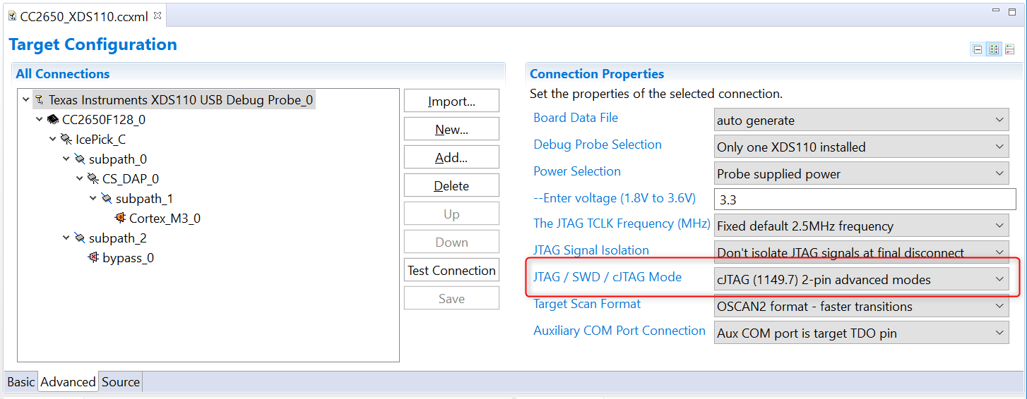

    I use the XDS110 to debug CC2650 Sensortag, there is external SPI flash I want to access during debugging. It works only with the devPack version of XDS110 for external SPI flash accessing. what's the difference between the devPack firmware and TMDSEMU110-U?

    The firmware is the same. However, I see from the Sensortag DevPack User's Guide that you need to configure your probe to 2-pin cJTAG to properly have the standard SPI port available on pins TDI/TDO. Are you configuring this?

    I figured out the issue, the TMDSEMU110-U however still affect the TDI/TDO pins in hardware/firmware. After take the two pins out, TMDSEMU110-U works fine with the CC2650's external spi flash.
