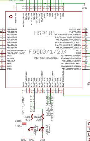

    Where the EZFET_VCCEN1 and EZFET_VCCEN2 controls are connected to the MSP430F5528 which runs the EZFET firmware:
    From looking at the MSP Debug Stack source code in slac460 I think the EZFET will select the LDO as the EZFET_VCCTARGET supply voltage when Energy Trace is disabled, but don't have the test equipment to measure this.
    Can you confirm if the MSP Debug Stack provides a mechanism to switch EZFET_VCCTARGET supply voltage between EZFET_VCC (the 3.3V LDO output) or EZFET_VCCOUT (the output from the software controlled DC-DC converter)?

    Yes this is what I was getting at - thanks for helping me clarify.  I too downloaded the debug stack at one point, but I couldn't discern where the debug stack actually enabled the LDO.  I also thought about modifying the stack to turn on the LDO by default but I was unsure of how to load the software, or how if it would interface properly with the CCS after it was loaded.
