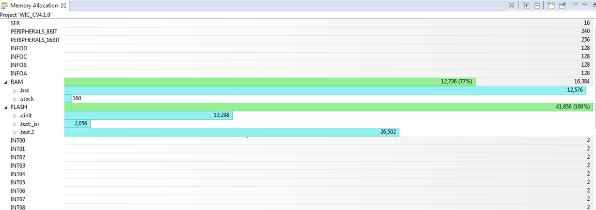

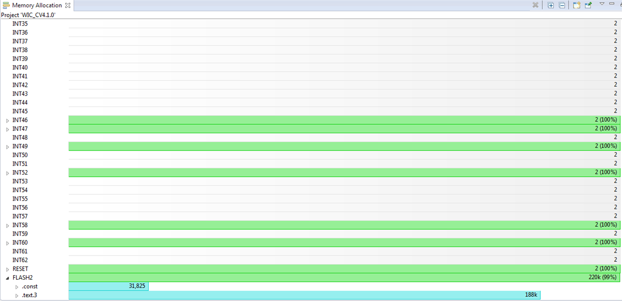

I am using MSP430F5438a and getting the error of Program not fit into the available memory in frequently in .cinit and .const.
what it means ? how can i resolve this?
Kindly find the below linker command file and Memory allocation

If the same program i compiled in compiler version 16.9.0 not getting any error. Is it because of the linker command file? Though i kept the optimisation level 4 in both the compiler version 4.1.0 and 16.9.0
    An explanation of the error is described in the below link:
    http://software-dl.ti.com/ccs/esd/documents/sdto_ccs_build-errors.html#error-placement-fails-for-section-xxx-
    Please provide the exact full error as it appears in the build console.
    ki
    Kindly find the below details of error appeared in build console.
    **** Build of configuration Debug for project WIC_CV4.1.0 ****
    "C:\\ti\\ccs700\\ccsv7\\utils\\bin\\gmake" -k -j 8 all -O
    'Building file: ../ADC.c'
    'Invoking: MSP430 Compiler'
    "C:/ti/ccsv5/tools/compiler/msp430_4.1.0/bin/cl430" -vmspx --abi=coffabi --data_model=restricted -O4 --opt_for_speed=0 -g --include_path="C:/ti/ccs700/ccsv7/ccs_base/msp430/include" --include_path="C:/ti/ccsv5/tools/compiler/msp430_4.1.0/include" --advice:power=all --define=__MSP430F5438A__ --diag_warning=225 --display_error_number --diag_wrap=off --silicon_errata=CPU21 --silicon_errata=CPU22 --silicon_errata=CPU23 --silicon_errata=CPU40 --printf_support=minimal --preproc_with_compile --preproc_dependency="ADC.d"  "../ADC.c"
