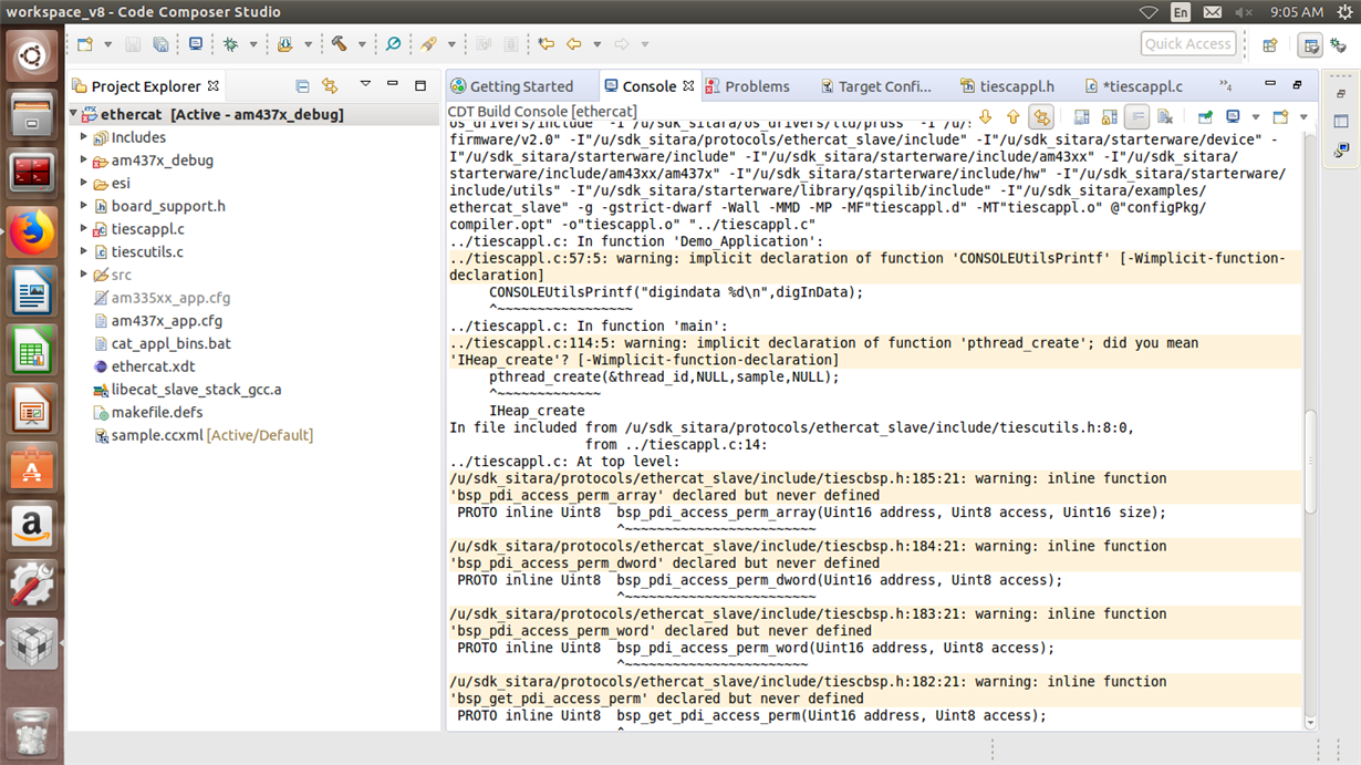

    For customizing ethercat slave I have included pthread.h file in c code. But while building it showing error. How to link pthread.h file to my code.

    The screenshot only shows warnings - are these what you were referring to as errors?
    I don't have as much knowledge about the GCC compiler as the TI compiler, but in general terms the "implicit declaration" warnings mean that the source file is calling a function for which the compiler has not seen a declaration ("prototype") yet. Make sure that pthread.h (or another header file) has the prototype for these functions and the header file is #included in the C source file.
