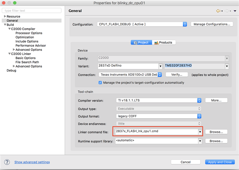

2) In "blinky_dc_cpu01" > "Properties" > "General" > "Configuration", I change from "CPU1_RAM_DEBUG" to "CPU1_FLASH_DEBUG" (since I want to load the program on flash, not on RAM)
3) In "blinky_dc_cpu01" > "Properties" > "General" > "Project", I select the TMS320F28379D device, the XDS100v2 debugger and the and put "<none>" in "Link commander file" (since leaving the 2837x_FLASH_lnk_cpu1.cmd will cause a lot of errors). Apply and close.

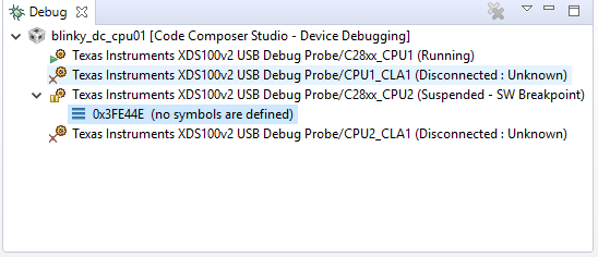

6) Debug "blinky_dc_cpu01" and select to load it just on CPU 1 (following image). Wait for the program to load, and, when it finishes, now on CCS Debug window, do not "Resume" it.
7) In the Debug window, select CPU 2 (Texas Instruments XDS100v2 USB Debug Probe/C28xx_CPU2) and "Connect Target". Its status goes from "Disconnected" to "Suspended". While it is selected, go in "Run" > "Load" > "Load Program" and select "blinky_dc_cpu02.out". Now, apparently, both cores have their respective programs (following image).

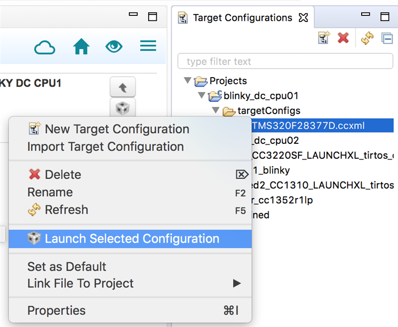

Observation: if I right-click on the .ccmxl file, there is no "Launch Selected Configuration" option, as oposed to the Original Question.

    In step 2 was it this box that you were clearing?
    If so that is ok.  What happens is that when you select a device in the project properties it adds the default linker command file.  In your case the project is already referencing linker command files via the linker options (vs having the file directly in the project) and thus you would get build errors without clearing this.
    Technically you don't have to do step 2 as the project already has a target configuration file in the targetConfigs folder.  You could just double click on that and change the device there.
    These projects are setup in a slightly odd way.  Anyway what you did should be fine.
    As to the question regarding the "Launch Selected Configuration".  That is available via the Target Configurations view and not the Project Explorer.  If you right click on the file in the project explorer you will not see that option.  You have to do it here:

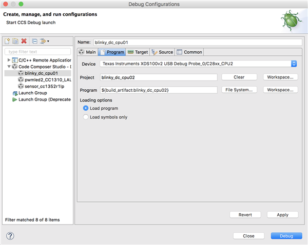

    One other thing that you can do which will make the debug launch process easier is to edit the debug configuration to load the appropriate program on each core at launch.

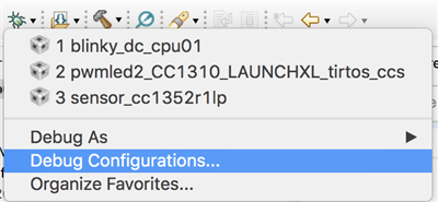

    Go to the little arrow beside the bug button and select Debug Configurations.
    Once the dialog box opens select Blinky_dc_cpu01 in the tree on the left.  The click on the program tab on the right.  Select CPU2 in the drop down box.  Click on the workspace button beside the Project field and select the project for CPU2.  This will automatically fill in the project field and the Program field.
    Now when you launch it will load both of the cores.

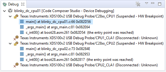

    Launching both cores at once is working as a charm:

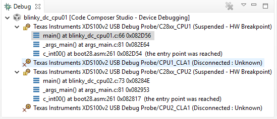

    And running/debugging them individually also:
    But as soon as I hit the reset button, the code on CPU 2 is gone:
