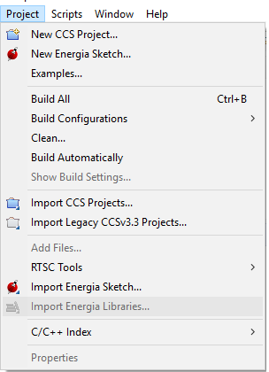

I am using Code Composer Studio version 8.0.0 and the option "Import Energia Libraries from CCS" is not enabled for me.
I'd like to know why and how can I fix it.
best regards,
Sara
    You first need to import an Enegria Sketch. Then you can import a Library to it.
    ki
  • Yes, my idea was to use a C++ library from Energia (aJSON) inside a CCS project (in C), I was thinking if Code Composer would make some modification to make it possible. But I just realized that we can only import Energia libraries into Energia projects. My solution was create an Energia Sketch and use C libraries trhough extern "C".
