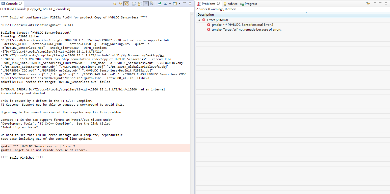

I/m using TMS320F28035.

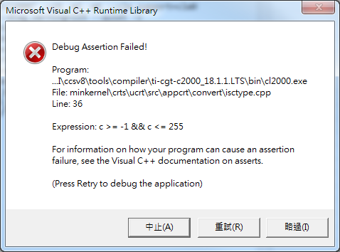

I can compile and build the project on CCS 6.1.3 . However when I upgrade the version to  CCS 8.0.0 , the error came up .
How to fix it to be able to compiled on CCS8.0.0 ?
  • In the screen shot I see some -i options with directory paths that include characters which cannot be represented in 7-bit ASCII encoding.  My guess is the processing of these characters causes the problem.  Please try changing all the paths and file names so that only 7-bit ASCII characters are needed.
    Further background on this topic can be found in this forum thread.
    I cannot explain that.  I expect you would experience this same problem with the older tools.

  • Thanks for the advice
    I've change the path ,and another error shown
    my flash.CMD file  show the error ,But I didn't change anything?
  • I suspect you are experiencing the program will not fit error diagnostic.  If that page is not helpful, then I need to see exactly how the linker is invoked, along with all the diagnostics.  Please copy-n-paste that from the Console (not Problems) view.

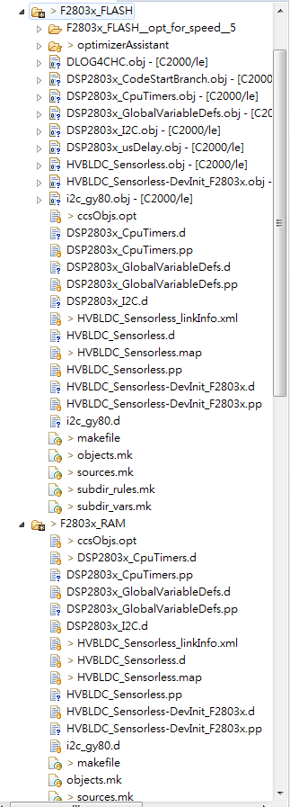

  • Diagnostics like ...
    "../F28035_FLASH_HVBLDC_Sensorless.CMD", line 54: error: progRAM memory range
    overlaps existing memory range RAML0L1
    "../F28035_FLASH_HVBLDC_Sensorless.CMD", line 64: error: BEGIN memory range has
    already been specified
    ... occur because you use two linker command files, when you should perhaps use one.  The two you use now are ...
    "../28035_RAM_lnk.cmd" "../F28035_FLASH_HVBLDC_Sensorless.CMD"
    However, that does not explain the many diagnostics like ...
    warning: creating output section "EmuBModeVar" without a SECTIONS
    specification
    The likely cause of this message is some other linker command file is missing.
    The linker command file(s) is closely related to the memory configuration on the system, and the libraries used.  I lack the expertise on C28x to help with such details.  I recommend you start a new thread in the C2000 device forum.  Or, if you prefer, I can move this thread into that forum.
