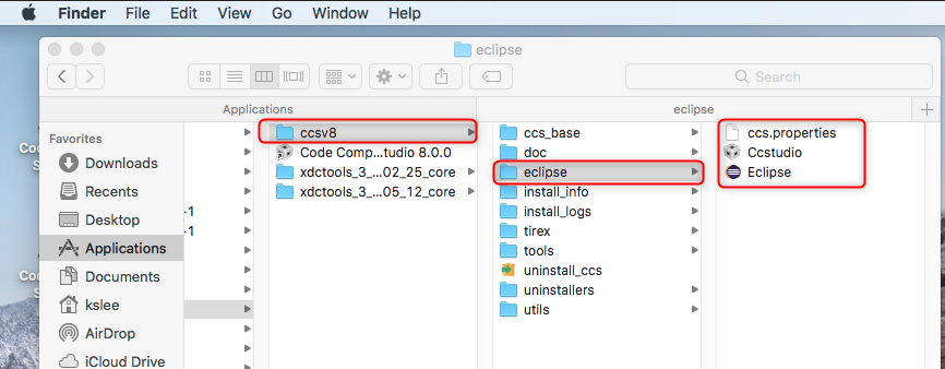

    You would get the native Eclipse splash screen if you launched CCS with the Eclipse launcher: <CCS INSTALL DIR>\ccsv8\eclipse\Eclipse
    The correct way to launch CCS is with the CCS launcher: CCS INSTALL DIR>\ccsv8\eclipse\Eclipse\Ccstudio
    Please double-check which launcher is used

  • Hello Ki, And thanks for your response...
    But I don't have Ccstudio at that path.
    I have both of these in the ccsv8 path (within the Eclipse 'package'):
    /Applications/ti/ccsv8/Ccstudio
    /Applications/ti/ccsv8/Eclipse
    and both boot to the Eclipse splash screen.
  • That doesn't look right. Both apps should be under the ./eclipse subfolder
    To confirm, this is not the case for you?
