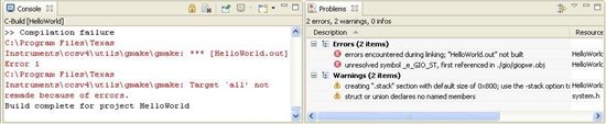

 I'm learning how to use Code Compose Studio Version: 4.1.3.00038  to compile and debug a very simple C program. The microprocessor that I'm using is TMS470R1VF689.
 I'm able to use IAR software to write a simple code to blink LEDs but having problem using the CCStudio.
 Can anyone please explain to me what is wrong here?
Software Tool: Code Compose Studio Version: 4.1.3.00038
Microprocessor: TMS470R1VF689.
Here, I'm trying to program a very simple code to blink a LED by toggling pin GIOA2, but I got the following code compilation error using the CCStudio.

  • Soo,
    Your unresolved symbol error would indicate to me that you are not including a necessary library as part of your build option. You will have to see where e_GIO_ST is defined and make sure that it is part of your build. Since I'm not familiar with your application, I can't offer much more insight. Hope this helps.
