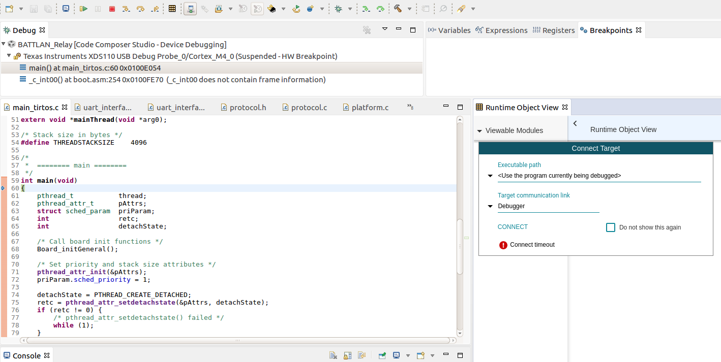

I am running CCS 8.0.0.00016 on Ubuntu Linux 16.04, with a custom application running on TI-RTOS on a CC3220SF module.
I can debug and step through my application without issue, however whenever I attempt to connect to the device with Runtime Object Viewer, from the debug view, I get a Connection Timeout.
What are the possible causes of this issue?  I can't find any guidance on this in the ROV documentation.
  • Joss,
    That is odd. I can see from the screen capture that you have a valid debug session. I will loop in an ROV expert when they get in but I had one thought. I see in your debug view that you have a terminated debug session. I wonder if ROV is trying to connect to it. In the debug view you should be able to click on the double grey X on the right hand side to remove terminated debug sessions. Could you give that a try, close ROV, open it again and see if it can connect.
    John
  • John,
    I tried closing the terminated debug sessions with the double x's, but ROV still times out while trying to connect to the debugger.  I tried closing and reopening CCS as well, with the same results.
    Joss

  • Joss,
    you can get more debugging info with the following steps.
    1. Go to your CCS installation and navigate to ccsv8/eclipse directory.
    2. Open ccstudio.ini and add the line
    -Djxbrowser-remote-debugging-port=9222
    There is already a line that starts with -Djxbrowser in that file, so add your new line just below that line.
    3. Restart CCS and the debugger, and start an ROV session.
    4. Go to http://127.0.0.1:9222 in Chrome, and click on "Runtime Object View".
    5. Click on the tab Console, and copy and post here the complete output.
    I used Chrome, but other browsers might work too. Also, you can use a port other than 9222, if that one is already used.

    Here is the output I'm seeing:
    [Deprecation] /deep/ combinator is no longer supported in CSS dynamic profile. It is now effectively no-op, acting as if it were a descendant combinator. You should consider to remove it. See www.chromestatus.com/.../4964279606312960 for more details.
    rovapi.js:557 _connect: connecting ...
    rovapi.js:588 activeDebugContext: {
       "data": [
             "core": "Texas Instruments XDS110 USB Debug Probe_0/Cortex_M4_0",
             "project": "relay"
    agent.js:896 WebSocket connection to 'ws://127.0.0.1:54908/' failed: Error in connection establishment: net::ERR_CONNECTION_TIMED_OUT
    createClientModule @ agent.js:896
    rovapi.js:633 ROV _connect failed to acquire DS: socket error
    rovapi.js:273 Error: setExecutable() failed: ROV _connect failed to acquire DS: socket error
       "data": [
             "project": "relay"
    (anonymous) @ agent.js:829
    _fulfilled @ q.js:794
    self.promiseDispatch.done @ q.js:823
    Promise.promise.promiseDispatch @ q.js:756
    (anonymous) @ q.js:564
    flush @ q.js:110
