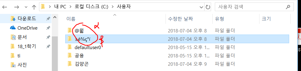

I am having same issue. I installed the version 8.000001 & I clicked that icon then it opened and automatically shutting down it self.
I am on window 10.
i tried that answer that ti gave at the related issue. But it does not solve my problem.... help me!

Also, do you have any unicode characters in your install path or workspace path (if you were able to specify a workspace)? Does your Windows username have unicode characters?
