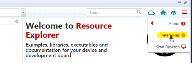

By default, TIREX uses c:\ti path as folder. However, TIREX informs this parameter can be changed in Preferences.
However, I was unable to find the right option on the meny Windows > Preferences. The root folder dedicated to IDEs is called c:\Others on my laptop.
I'm using CCS 8.1.0.
Thank you for your help.
  • Hello Rei,
    I believe that you need to access the Preferences menu within the Resource Explorer application (re: screencap below), rather than Windows -> Preferences in the parent Code Composer Studio IDE.
    (This probably should be made clearer in the dialog to avoid ambiguity.)
    Please advise if this helps?
    Regards, Alex
  • Thank you for the hint, it solved my issue.
    My screen wasn't large enough to display the menu symbol for the TIREX > Preferences options.
    Mentioning the exact location of the Preferences menu in the dialog bow would be great.
