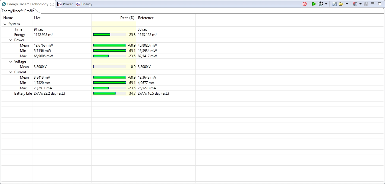

The first pane provides comparison between current and reference measures.

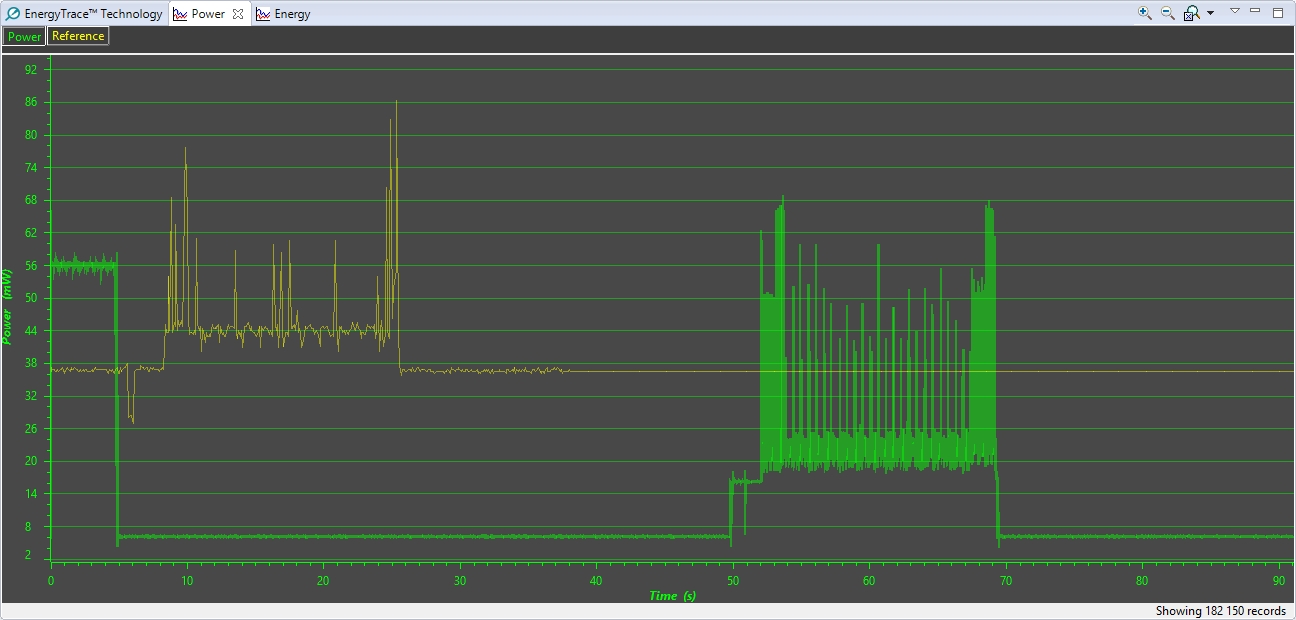

The second pane displays a graph with current in green and reference in yellow. How can I synchronise both series to compare the peaks of power consumption?
Reference starts at 8 s while current starts later on at 50 s. I would like to have both series at start one on top of the other, by moving either reference by +42 s or current by -42 s.
Thank you!
  • Olivier,
    Unfortunately there is no way to change the reference directly on the EnergyTrace GUI - you will have to manually change it on the data to properly display it.
    The data can be saved also in CSV format for easier post-processing.
    That said, I recall there were some discussions to improve the display features of EnergyTrace view - perhaps have them closer to what the Single Time Graph has. I will try to follow up and see if there is any progress in this regard. This may not happen until the next major version of CCS, though.
    I apologize for the inconvenience,
    Rafael

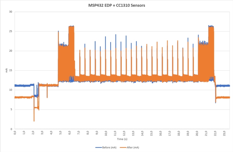

  • Using Excel is doable, but rather slow as CSV files are very large.
    One possible solution would consist on implementing a very basic trigger, either resetting the board at the start of the record or flashing a LED to show a surge in power consumption.
    On the example below, I combined two different EnergyTrace CSV files into an Excel file. The result is, RTOS for the MSP432 MCU saves 3 mA.
    By setting the trigger to "custom" you can frame the data capture on your system to known values. However, this works asynchronously from the main processor - i.e., it is completely dictated by the host PC and its somewhat imprecise data timekeeping.
    Would that help get closer to what you need?
    Rafael

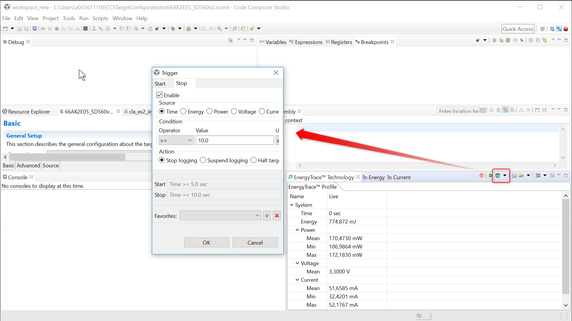

  • Yes, I managed to get the traces synchronised by using a LED as trigger.
    Toggling a LED on then off for 10 ms starts the recording, as a LED requires 41 mW.
    Time difference is minimal and allows good comparison. The LED are toggled every 500 ms.
    I posted more details on the section Setting a Trigger for Better Synchronisation at Ultra-Low Power with EnergyTrace.
    Thank you for your help in solving this question!
