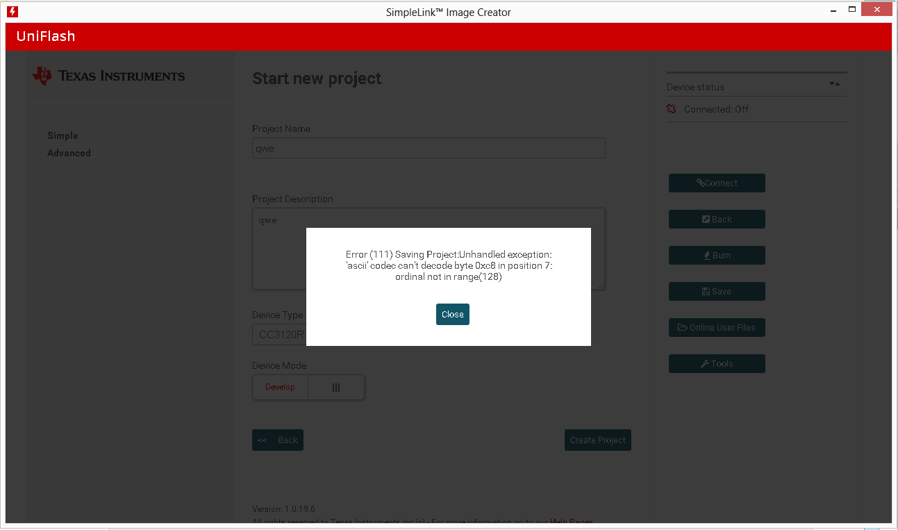

I've just downloaded and installed Uniflash to set up CC3120Boost+CC31XXEMUBOOST, but get system error with unicode "0xc8" byte.
The full versions are "uniflash_sl.4.3.0.1802" and "uniflash_sl.4.3.1.1835" from http://processors.wiki.ti.com/index.php/Category:CCS_UniFlash .

The steps (for 4.3.1):
1. Enter "cc31", choose "CC31XX / CC32XX"
2. Click "Start Image Creator"
3. "New Project"
4. Project Name "qwe"; Project Description "qwe"; Device Type: "CC3120R"; Device Mode "Develop";
5. Click "Create Project"
Got: "Error (111) Saving Project: Unhandled exception: 'ascii' codec can't decode byte 0xc8 in position 7: ordinal not in range(128)"
After that I can work with project (connect / show files and device information), but this error appears on several actions, and project can't be saved.

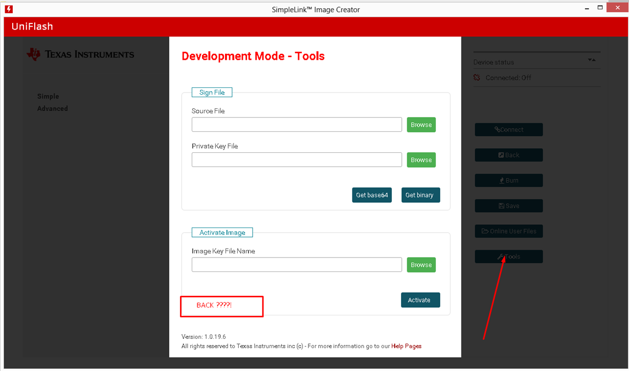

Also I have a lot of troubles about getting in several modal windows without "Back" button (so I can't close it, only restart uniflash).

    Unfortunately I couldn't reproduce this issue with Uniflash 4.3.1.1835 on my Windows 10 build 1709.
    All the errors described by you seem to indicate there is a problem with your installation of Uniflash or with temporary files. Can you go to the path below and either move or delete it?

    Also, the interface is somewhat different than what I see it here - there are no modal windows, but instead they are inserted into the same window:

  • Thanks for replying!
    Yes, your guess is right. I have default username "Илья", and "И" is 0xC8. Renaming "C:\Users\user\AppData\Local\Uniflash" to "C:\Users\user\AppData\Local\___Uniflash" doesn't help. But re-login to the account with ascii username has solved the issue.
