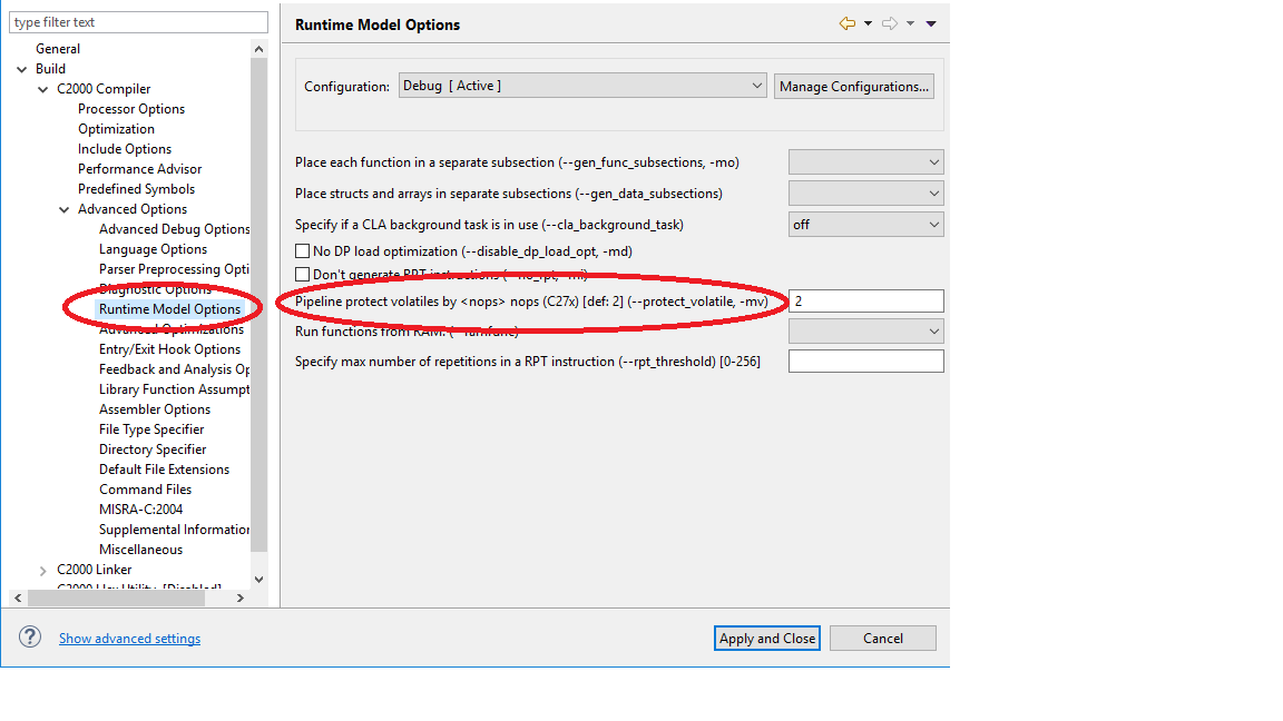

I need to set the compiler options for CCS8 project.  They are:
-c  -pden -O1 -on2 -mn -ms --symdebug:dwarf  -d"DEBUG" -d"LARGE_MODEL" -ml -mt -mv -v28 -pdv –me
I cannot find some of them in CCS8 user interface. So I try to set the options in “Edit build flags” window.
However the changes I made (-mv option) do not come to the project properties and do not have any effect. After “OK” I have:
Please advise me how to edit and save compiler options.

  • I found the project setting for -mv.  See the screen shot below.  One minor caveat ... You have to enter a value.  The compiler default is 2.  So start with that.
    Another general tip to consider ... Another way to enter compiler options which CCS does not see is with the option --cmd_file=custom_options.txt.  Read about it in the C28x compiler manual.
