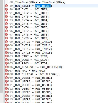

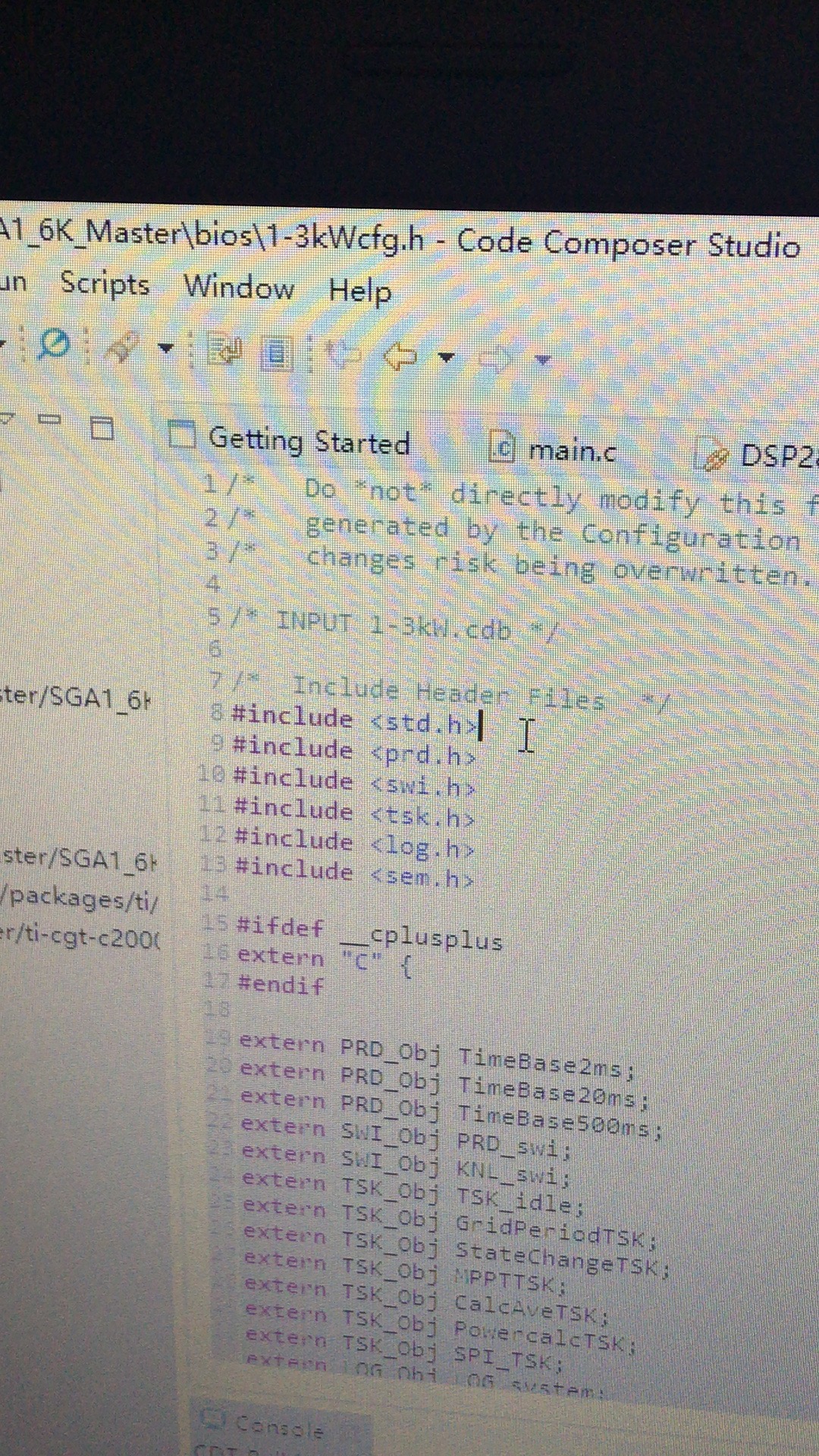

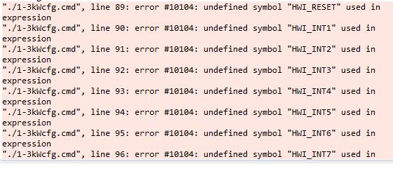

porting 3.3 project into CCSV8. Seems lack of the header file, need to import.
But I cant find it.
Pls help to suggest.

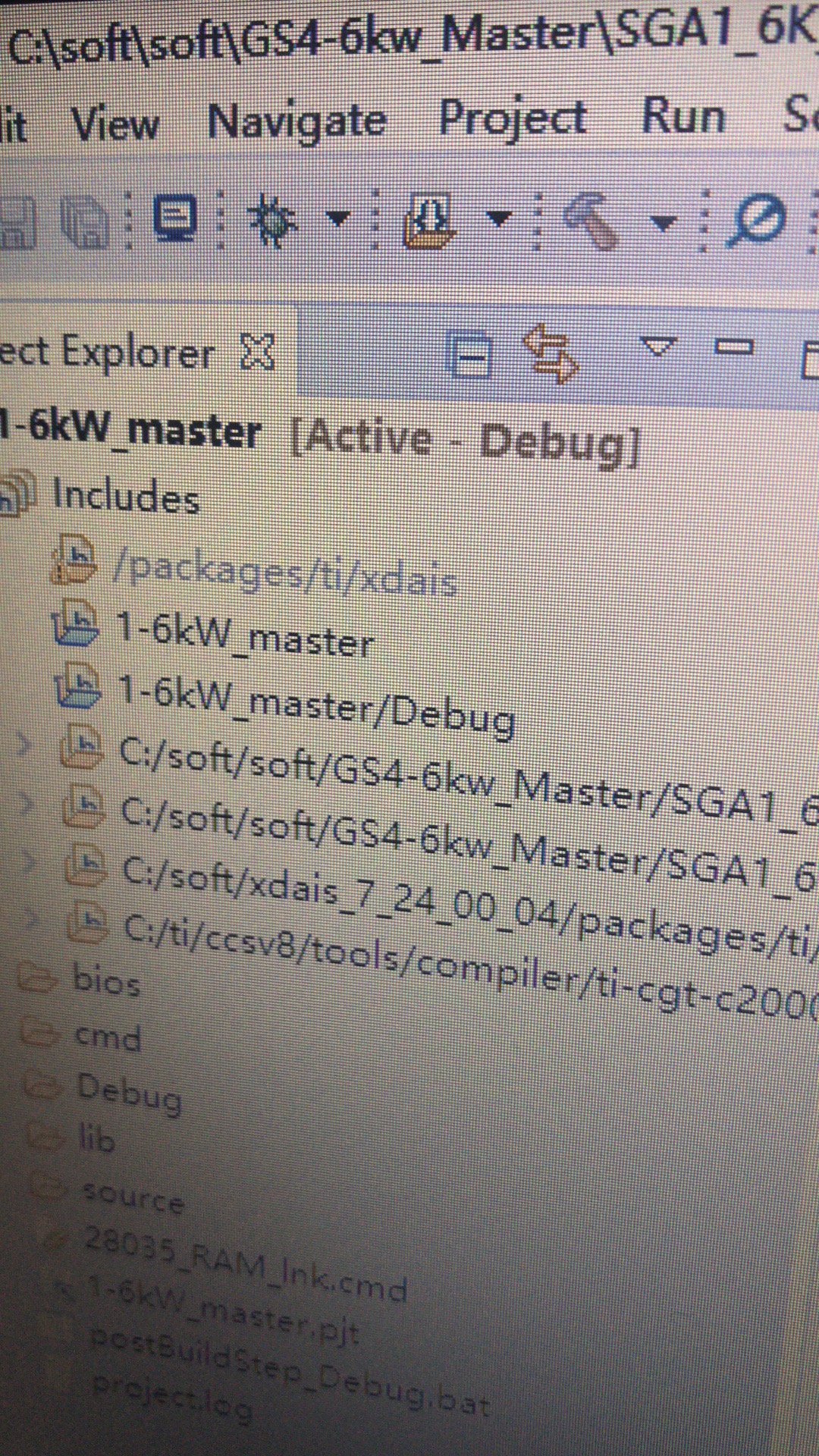

It looks one of your include search paths is broken (packages/ti/xdais). Carefully check your include search paths in the project build properties and make sure that the paths are valid. If your paths use a build variable, make sure that variable is valid.
