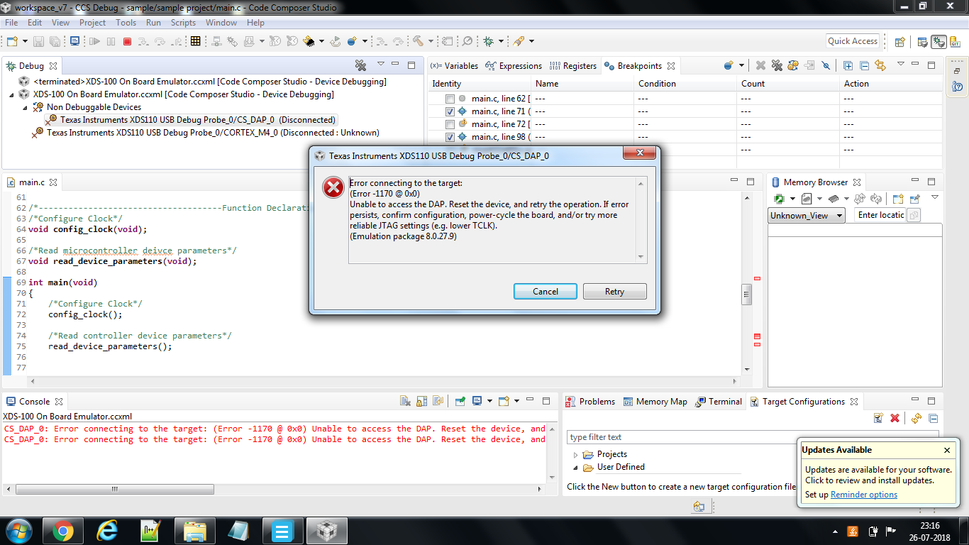

  • Hi Bob,
    I have followed the things suggested by you, but still i am unable to debug the code. Plz find the attached screenshot.
  • The "check for test connection" you mentioned ensures that _something_ is connected, but you can (obviously) still have some hardware issues. Are you able to try your connection with another LaunchPad? (say, with one of the stock examples).?
    -Bob L.
