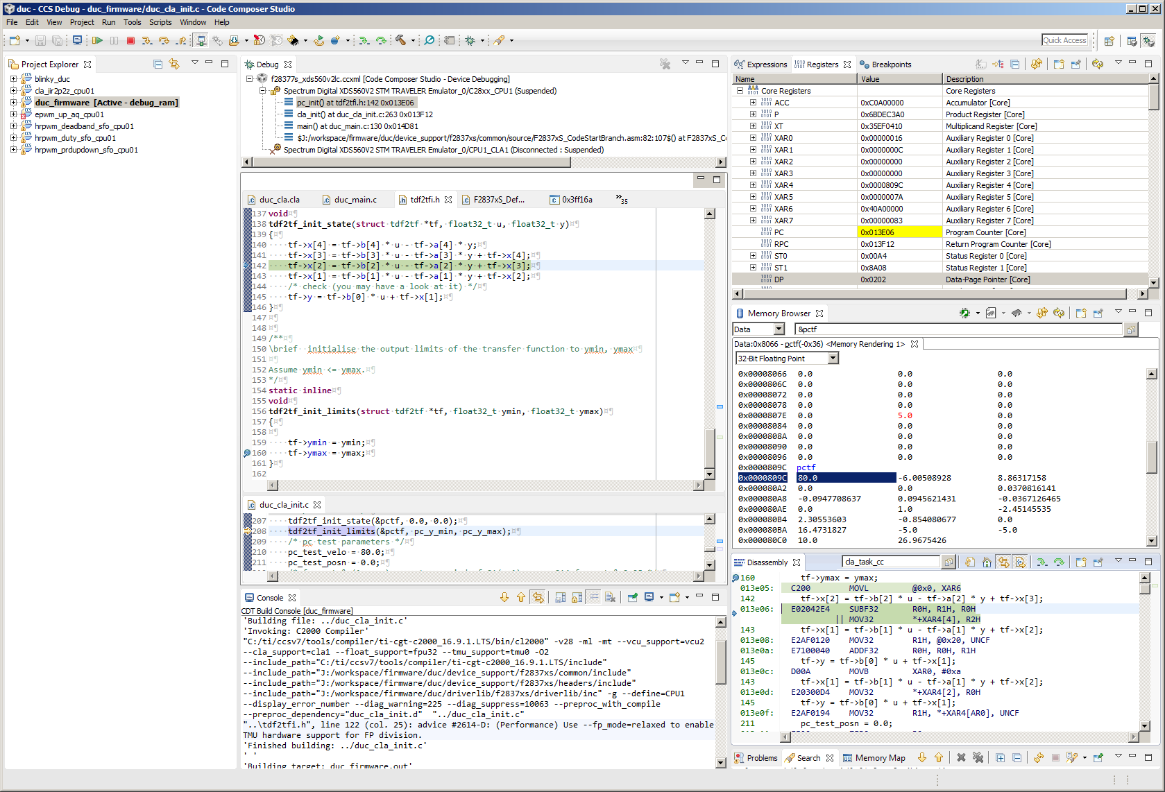

it took me half a day to discover the following issue: I try to initialise a structure that crosses an AMODE = 0 page using inline functions, -O2 set. The structure starts at 0x809c, the element I want to set is at 0x80c0 = page 203, offset 0. Compiler sets 0x8080 = page 202, offset 0 instead (red 5.0).
I hope the CCS screenshot gives you enough additional information.

    In the asm-file generated are the following interesting lines:
    885        MOVW      DP,#_pctf+34          ; [CPU_U]
    897
        .dwpsn    file "..\tdf2tfi.h",line 159,column 5,is_stmt,isa 0
            MOVL      @_pctf+34,ACC
    939
        .dwpsn    file "..\tdf2tfi.h",line 160,column 5,is_stmt,isa 0
            MOVL      @_pctf+36,XAR6        ; [CPU_] |160|
    Seems that I (un)fortunately catched the unlikely case, that the page border lies between the structure members ymin and ymax. Here again the generating C-function:
    static inline
    void
    tdf2tf_init_limits(struct tdf2tf *tf, float32_t ymin, float32_t ymax)
        tf->ymin = ymin;
        tf->ymax = ymax;
    The compiler accidentially assumes both in the same page, but actually, they are not.

  • Your analysis looks correct.  Unfortunately, you forgot to give me the compiler build options.  Please copy-n-paste that from the Console view in CCS.

  • Thank you for sending in the test case.  I can reproduce the problem assembly code.  Now that I understand everything better, I can see that it is a known issue.  You can look up SDSCM00050582 with the SDOWP link below in my signature.  The workaround is to define all data shared between CLA and C28x in the .c files, and not the .cla files
    This issue was reported quite some time ago.  I don't know why it has not been addressed.  I will look into that.
