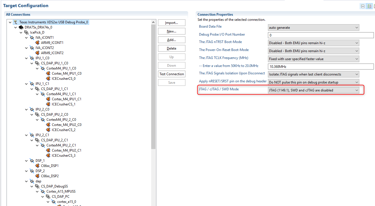

I'd like to take advantage of the Hardware Trace Analyzer tools built into Code Composer Studio v7.0 (such as Function Profiling) as described in SPRUHM7B. The target I would like to profile is the C66x DSP core on an AM5716 processor. The DSP firmware is built on top of TI SYSBIOS. I have a target configuration in Code Composer Studio with which I can successfully connect to the processor, load programs, and use the debugger. However, when I try to open any of the Hardware Trace Analyzer tools, I receive the following error message:
Error connecting to the target (Error -2131 @0x1)
Unable to access device register. Reset the device, and retry the operation. If error persists, confirm configuration, power-cycle the board, and/or try more reliable JTAG settings (e.g. lower TCLK). (Emulation package 6.0.504.1)
I'm using an XDS200 emulator to connect over JTAG. A little bit of research here on the E2E forums suggested that I might need to set the JTAG / cJTAG / SWD Mode setting of the target configuration to SWD Mode - User COM port is target TDO pin, but after trying that I wasn't able to connect at all:

    Do you get that initial prompt that the debugger needs to initialize the Hardware Trace Analyzer? Or do you get that connection error ASAP?
    In any case, you should be able to use the Hardware Trace Analyzer with your XDS200. It will use the ETB on the C66x as the transport and send the data over JTAG. I was able to use it without issue on the C66x of my DRA74x (similar to an AM5728) using an XDS200. I was using later versions of CCS however (v8.1.0 and v7.3.0). Trace Analyzer had all sorts of issues with early version of CCSv7 so you may want to try out a more recent version of CCS to see if that helps

    I receive the connection error immediately after trying to launch a trace configuration from the Hardware Trace Analyzer menu. The configuration dialog does eventually open, but it takes about 10-30 seconds to do so. I will look into trying a newer version of CCS to see if that helps.
    Can you clarify which setting you were using for JTAG / cJTAG / SWD Mode under the target configuration for the XDS200?

    Yes, please try it out. Starting with v7, we had some nasty issues with Trace Analyzer that took a few versions to improve (it still has issues but it is definitely better)
    ki
  • After upgrading to CCS 7.4, I am now able to use the Hardware Trace Analyzer. Thank you for your assistance!
