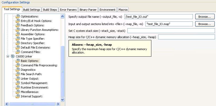

    I was able to fread() and then fopen() a file, with neither
    1. linker.cmd, not to mention its heap specification
    2. Project->Properties->C/C++ Build->Linker->Basic Options->--heap_size: leaving blank
    Why the file operation can still success? The link you provided
    http://processors.wiki.ti.com/index.php/Tips_for_using_printf#Heap_Size
    explains why heap is needed for file IO. So does my situation (1 & 2) even I am leaving --heap_size blank, CCS still defauls a certain value, which is not shown here?
    And when options are specified both in linker.cmd and Linker->Basic Options, which value is actually used? Does the value in anyone overrides the value in another?
    If you don't specify anything, then the linker will use default settings (0x400 each for heap and stack)
    The linker *.cmd file will be used in this case.
  • Zheng,
    Just adding to Ki's response, to verify how much heap and stack are being actually configured (among other things) please check the linker map file <test_file_IO.map> in the output directory.
    Rafael
