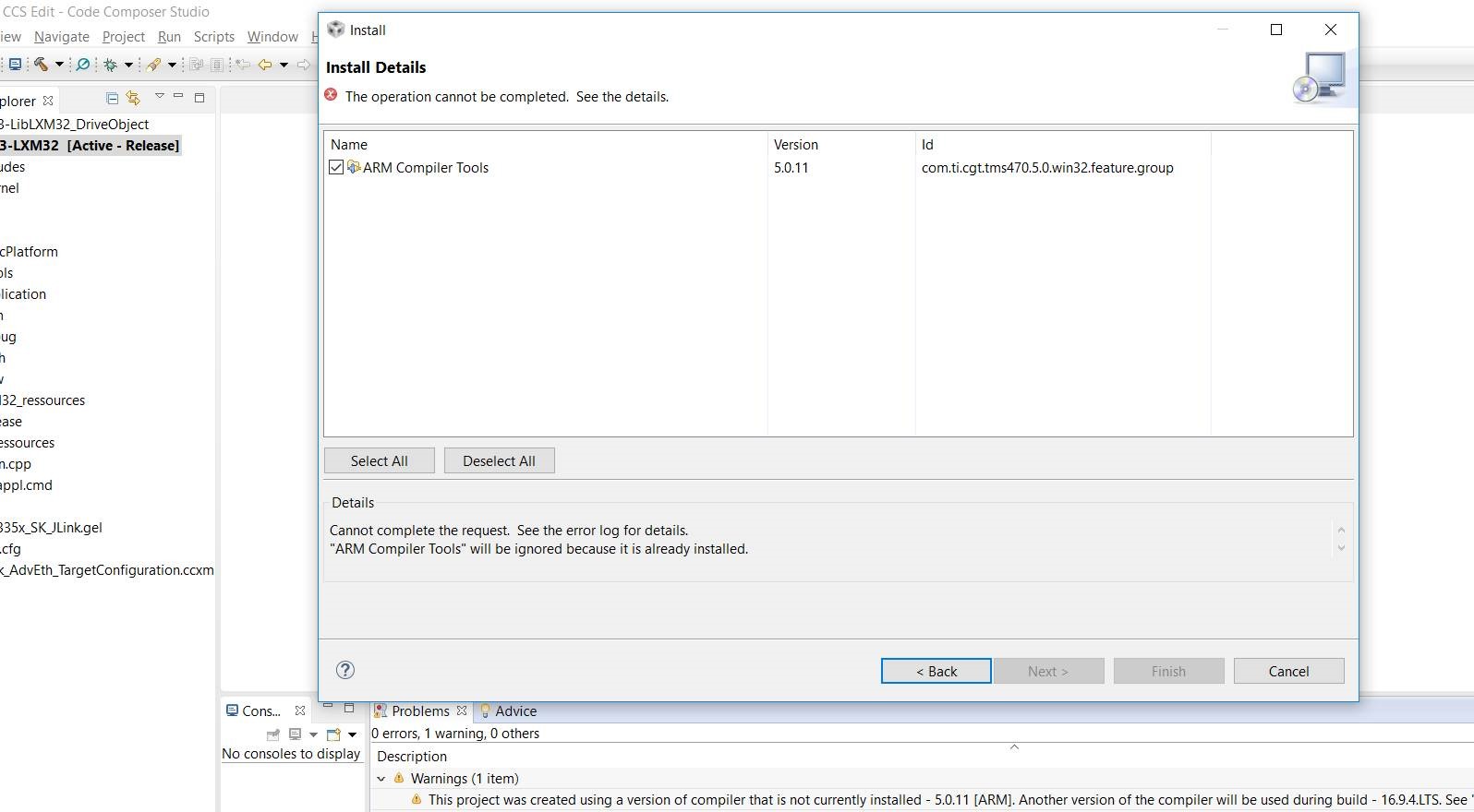

For one of my projects I need the ARM compiler tools version v 5.0. X.
When I open the properties from the project it reports that this version is not installed.
If I try to build this project, this mismatch is listed in tab "problems".
However, when I try to install this version from the compiler, it reports that it is supposedly already installed.

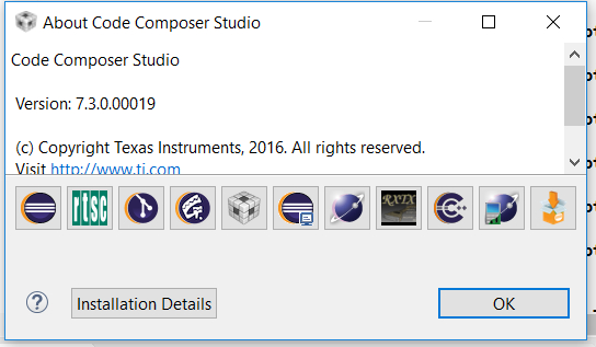

    Which version of CCS are you using?
    Could you check which ARM compiler versions are listed under Discovered Tools? Also which ones are listed in Help->About->Installation Details.

  • I use the Version V7.3.0.00019
  • Now here the Information about the installed ARM Compilers:

    I see that version 5.0.11 is listed as installed in the "Installed Software" list, however it is not discovered by CCS. Not sure how that happened, but could you try the following:
    In the Installed Software, select ARM Compiler Tools 5.0.11 and click Uninstall. Then after the CCS restart, go to Help->Install New Software, select 5.0.11 compiler and install it again.
    Let us know if that helps.

  • First I deinstalled the ARM Compiler Tools 5.0.x and after a restart I installed it again (I also started CCS with admin rights).
    After the restart of the PC - the version 5.0.11 is listed in the list of installed tools - but nevertheless not really installed on the PC.
    It will not listed within the list of discovered tools and it is not like the other compiler versions within the folder c:\ti\ccs7\tools\compiler\.
