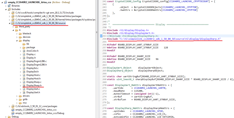

CCS: Links are there but obviously not noticed by CCS(see picture)
Other Parts Discussed in Thread: CCSTUDIO
include path is present but not working! If I replace it with the full path(see underlined with 'red', right side) it works fine. I repeated this in a 'new' workspace and then the problem does not occur! Is there a way to 'refresh' the wokspace?
regards, Laurent
