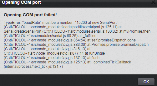

Also, this error is shown when I press "Target - Connect COM port - baud rate = 115200".

2) I do see my  "Texas Instruments Debug Probes - XDS100 Class Data Port / XDS100 Class Debug Probe" from my Windows 7 desktop after I connect my lauchpad via USB.
However, I get that COM port error. What should I fix to solve this problem?

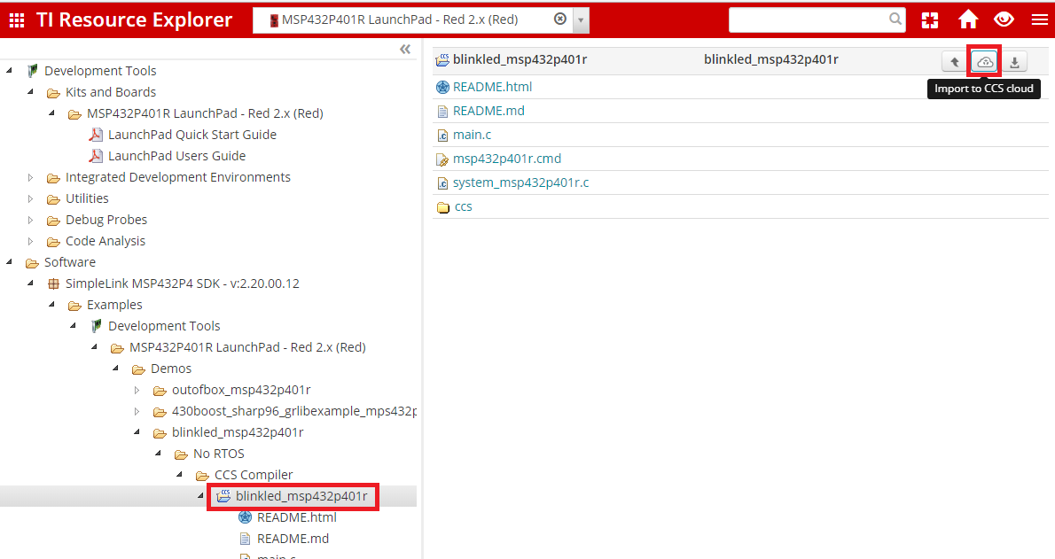

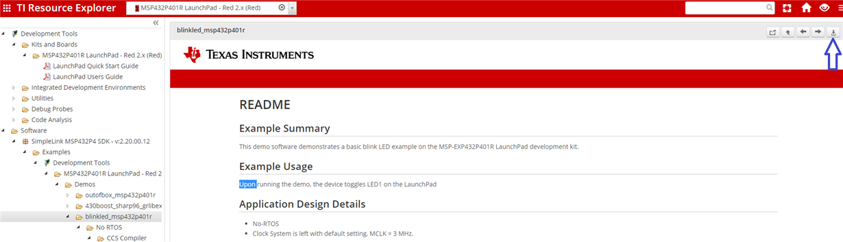

    I only saw the download button. Where can I import these examples to the Cloud?
    Also, I do see my  "Texas Instruments Debug Probes - XDS100 Class Data Port / XDS100 Class Debug Probe" from my Windows 7 desktop after I connect my lauchpad via USB.
    You need to go a bit deeper in the tree to the CCS project:
