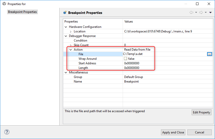

I am having three arrays of length 512 each. They are values of three phase sine waveform.Actually I want to keep those values separately in data file and I want to link that data file to the main source .C file. Is that possible or not??. If possible, how can I do that??. If there is any material regarding this please attach the link of that material. Please help me.
    This is possible with CCS via a beakpoint. Configure the breakpoint properties to "Read Data from File" to have the debugger read data from a data file. You can specify the address to read it to and the length to read:
    The data file needs to be in a special *.dat format. If you are not familiar with it, please refer to the the CCS HElp (Help -> Help Contents -> Code Composer Studio Help -> Views and Editors -> Memory View -> Data File Formats)
