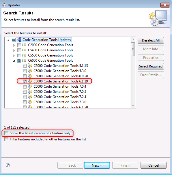

Compiler: C6000 Code Generation Tool 6.1.19
I'm looking for version 6.1.19 of the C6000 Code Generation Tool for CCS v4. This is not available from the typical down site (http://software-dl.ti.com/codegen/non-esd/downloads/download.htm).
Where can I get a copy?
