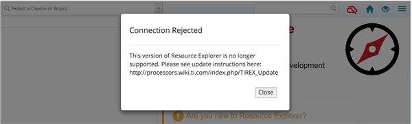

Iam using ccs 7.3 and 7.4 versionss, cannot able to access ti resource explorer,it asking ti rex update .
for going ti rex update , going for this link http://downloads.ti.com/ccs/esd/tirex/updates/tirex-3.6.10  , site showing site cant be reached .

    Get the error:
    I go to the link and copy the url shown.

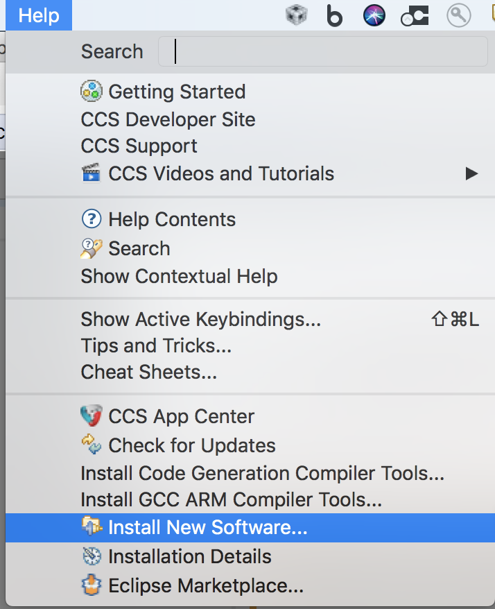

    I go to the help menu and select Install New Software
    In the dialog that opens I put the url in the box at the top and hit enter.  The contents of the update site are shown and I select them and click next.
    I will have to click through a couple more screens and accept a license.  Once I have done that it will install the updates.

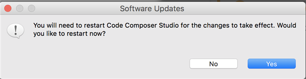

    When done it prompts me to restart which I do.
    After restart Resource Explorer then works:
