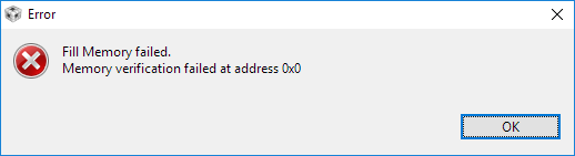

CCS/AM3358: PRU_0: File Loader: Verification failed...
Part Number: AM3358
my PRU application is based on the PRU_RPMsg_Echo_Interrupt0/1 example from the PRU Software Support Package (https://git.ti.com/pru-software-support-package).
The code compiles fine, but I get the following error when trying to load the firmware (CCS Version: 8.1.0.00011, XDS110 Debug Probe):
PRU_0: File Loader: Verification failed: Values at address 0x0000@Program_Memory do not match Please verify target memory and memory map.
PRU_0: GEL: File: C:\Users\... .out: a data verification error occurred, file load failed.
I figure it has to do with the linker linker command file and the GEL file, but I can't find the issue.

I can connect to the PRU's just fine through JTAG, but can't get the firmware loaded. Any ideas what might cause the issue?
Thank you!
