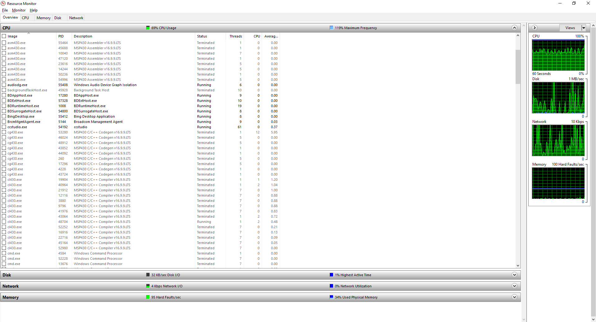

  • I'm not very familiar with Windows Resource Explorer. Is there a way I can gather data to present it here?
    When I run the compiler, it no longer stops to build the rts430x_lc_ld_eabi.lib file, so I'm not sure how to recreate my issue, but if I do a rebuild I can see several instances of acpia430.exe, asm430.exe, cg430.exe. Is that what I'm looking for?

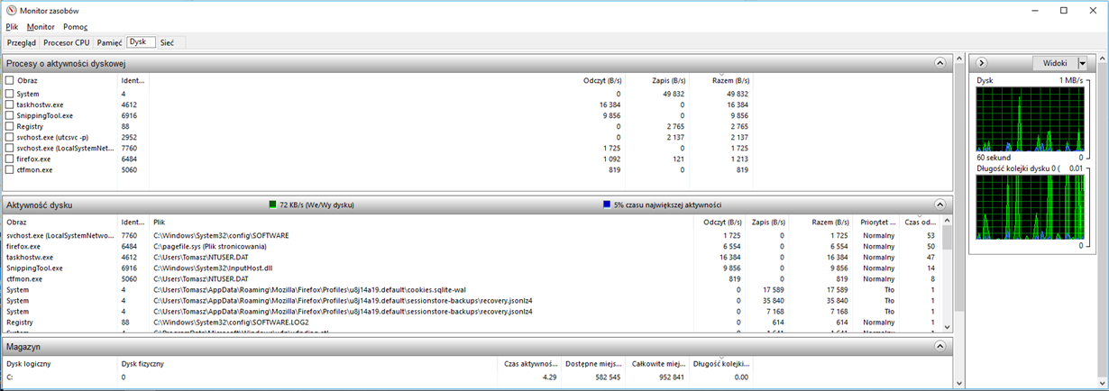

  • Windows Resource Monitor, not Explorer.
    Looks like this:
    If compilation takes so long, probably you have lack of I/O performance.

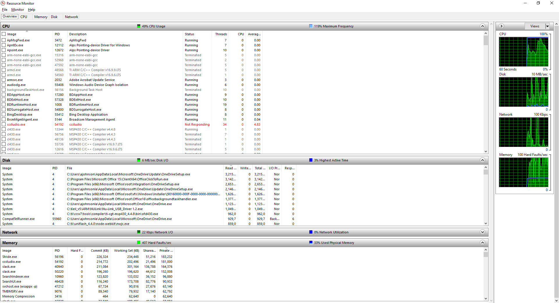

  • Here are some screenshots as Code Composer Studio starts up, as well as rebuilding a project.  Total time to start and rebuild is about 8 minutes.
    Code Composer Studio Starting up:
    Rebuilding 1:
    Rebuilding 2:
    Rebuilding 3 (about 56% complete):
    Rebuilding finished:
  • 8 minutes is much better than over 30m.
    CPU utilization @ 60% points to a HDD bottleneck.
    If you have HDD you can replace it with SSD.
    With SSD you should get 5-6 minutes.
