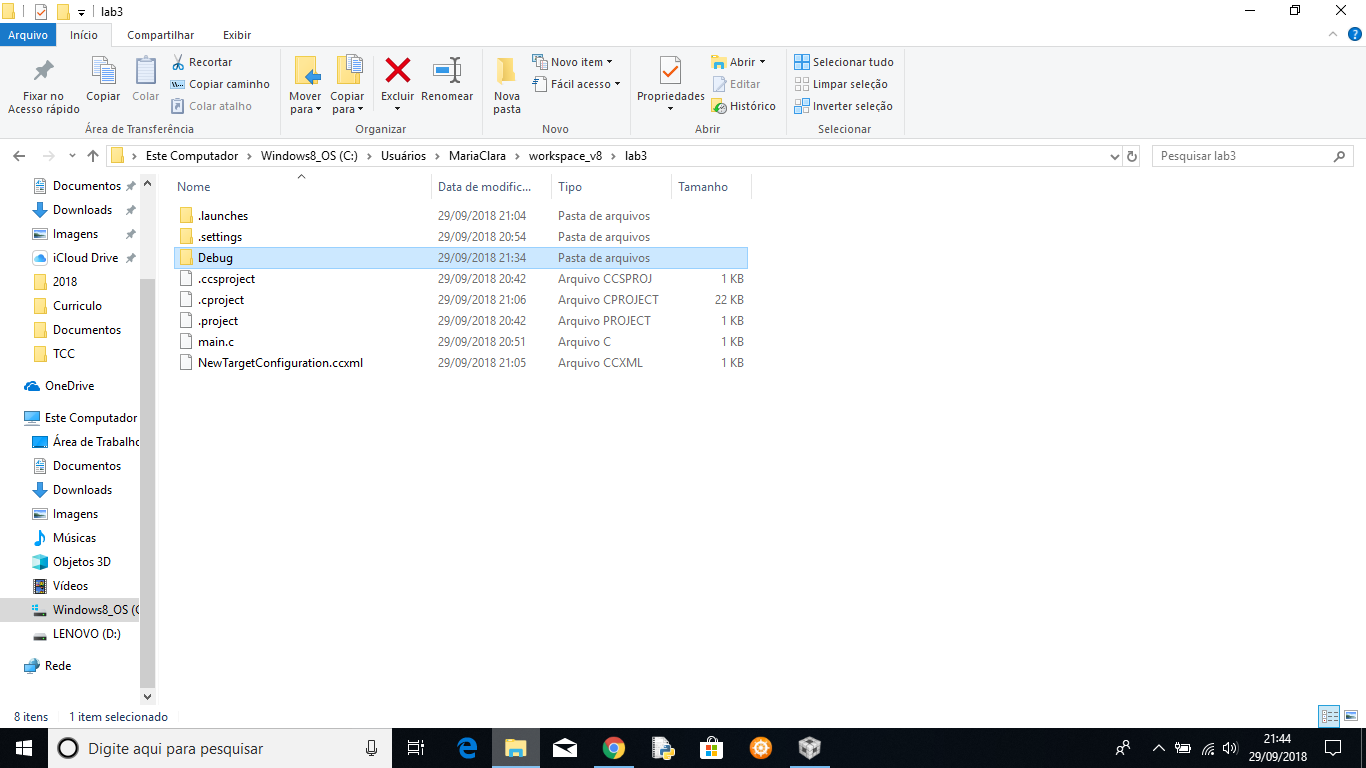

CCS: cannot open sourcefile "inc/hw_memmap.h"
After following steps from forum, Compose Studio have a different error.

  • Maria,
    Are you working with Tiva TM4C devices? If so, you need to add the path to your TivaWare installation to the project's compiler --include_path option (Project Properties->Build->Compiler->Include Options). Take a look specifically at this post
    Note that the path needs to be added under --include_path and not under --preinclude.
    Maria Clara Ferraz Bezerra de Miranda said:
    "C:/ti/ccsv8/tools/compiler/ti-cgt-arm_18.1.3.LTS/bin/armcl" -mv4 --code_state=32 --include_path="C:/Users/MariaClara/workspace_v8/lab3" --include_path="C:/ti/ccsv8/tools/compiler/ti-cgt-arm_18.1.3.LTS/include" --preinclude="C:/Users/MariaClara/workspace_v8/lab3" --preinclude="C:/ti/ccsv8/tools/compiler/ti-cgt-arm_18.1.3.LTS/include" -g --diag_warning=225 --diag_wrap=off --display_error_number --preproc_with_compile --preproc_dependency="main.d_raw" "../main.c"
    It appears that you have a couple of paths added under the --preinclude option (highlighted above). Delete those. Then add the path to TivaWare under --include_path and rebuild the project.
    Let us know if that resolves the issue.
