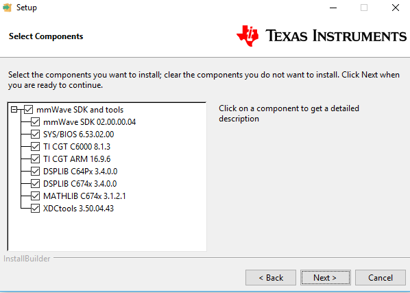

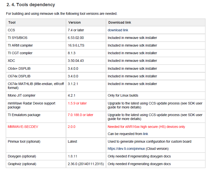

    Check the tool dependency: (according to User’s Guide I’ve check the exact name and version as follow)
    - Require CCS 7.3 or later (I’m 8.2)  OK
    - TI SYS/BIOS 6.53.2.00                      OK
    - TI ARM compiler 16.9.6 LTS          OK
    - TI DSP compiler   8.1.3   OK
    - XDC   3.50.04.43   OK
    - C64x+ DSPLIB   3.4.0.0     OK
    - C674x DSPLIB   3.4.0.0   OK
    - C674x MATHLIN 3.1.2.1   OK
    - mmWave device support packages 1.5.3 (or later)
    - TI Emulators package 6.0.0576.0 (or later)
    For the device support packages, I have been able to connect and send a pre-compiled bin file (Following process from User’s Guide) so I guess I’m good on that one.
    For the Emulator package I have download the “ti_emupack_setup_8.0.803.0_win_32.exe”. Should be goo right ?
    Here is the Console where it' blocked from SRR Demo :

    The differences I see right now are:
    ti-cgt-arm_16.9.9.LTS instead of 16.9.6.LTS
    ti-cgt-c6000_8.2.4 instead of 8.1.3
    Could you any other differences between your and my product/tool versions?
    Are you sure that you ran your installers with an admin privilege?

  • Q: ""C:\\ti\\ccsv8\\utils\\bin\\gmake" -k -j 8 all -O " I've got an 8 and you a 2
    Can you go inn your Build settings and tell me which version of compiler do you use ? (I use version 8.1.3 and I have a second one available 8.2.4)
    A: We have different CCS versions. Could you install CCS 8.2 in c:\ti\ccs820\ dir?
    In my reply:
    means that I am using 8.2.4 and 19.9.9 which are newer.
    Try with CCS8.2, C6000 8.2 and ARM 16.9.9.LTS.
