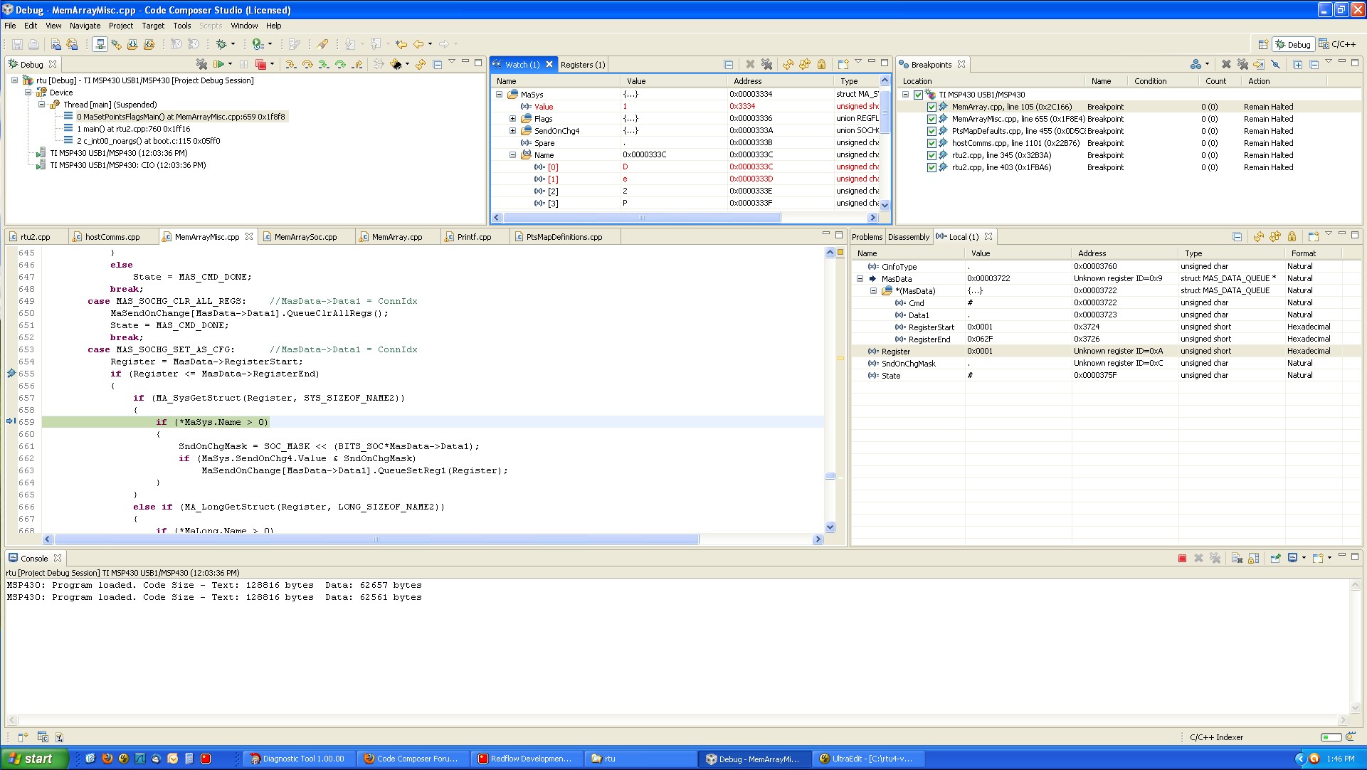

Using Code Composer Studio version 4.2.0 on Windows XP came across the situation today where watch variables were not updating.  As shown below MaSys.Name was not updating as I stepped through the few lines following the breakpoint.   Haven't been able to determine after what event the variable stops updating.  Will post a note if I can provide more info.
A workaround....  Removed MaSys from the watch window and added it again.  Works fine now.

    Was it just MaSys that had a problem or have you ever noticed a similiar issue with other locals in the watch view?
    ki
    It was MaSys only.  This is the first time this has occurred.  If I had to guess I'd say it stopped updating after a reset.  It could be related to this post http://e2e.ti.com/support/development_tools/code_composer_studio/f/81/p/55744/266590.aspx#266590, Part 2 - showing breakpoints lost after a reset.
