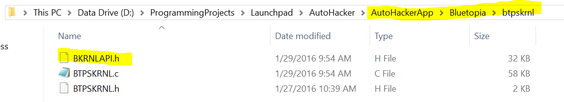

I am new to CCS and have been battling this issue for a couple hours now.
I am working on a personal project at home and downloaded the SDK for the MSP432 Launchpad + CC2564 Booster Pack. I am trying to get started with one of the sample bluetooth applications, "SPPDemo". I copied this program and support files to a separate directory, renamed the project to "AutoHackerApp", and set about updating the includes paths to get the project to build.
The error message I get is the coveted "gmake: *** No rule to make target" message:

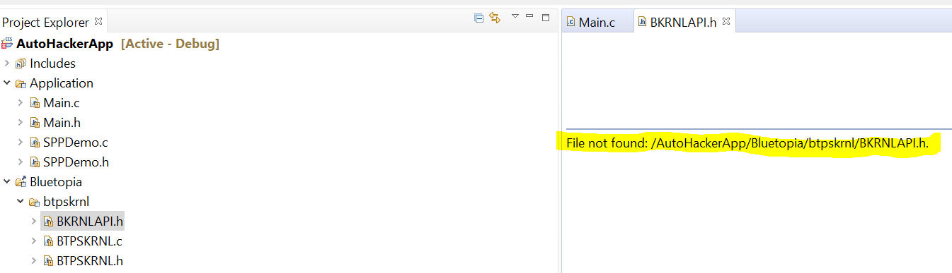

Here it seems to be looking in the old directory location for the sample file, but when I click on the program file in project explorer it appears to be looking in the right location but can't find the file:
The directory it is looking in here should be correct:
And I have updated link and include path I could find in the build settings but am still having this issue.
Thanks in advance for the assistance.
  • Hello Robert,
    path to BTPSKRNL.c includes spaces.
    Eclipse comes from old UNIX/Linux world and many tools used by Eclipse do not work having spaces in paths.
    <<< I copied this program and support files to a separate directory, renamed the project to "AutoHackerApp", and set about updating the includes paths to get the project to build.
    Try to import a needed project from your original installation dirs. Coping and renaming could destroy relative paths between products, libs and examples.

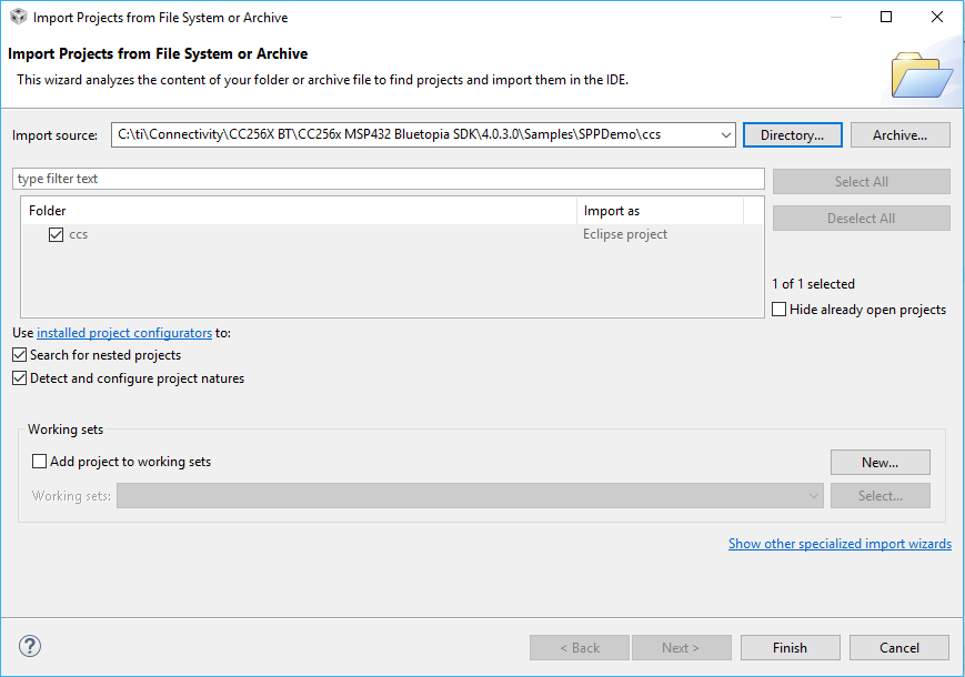

  • Hello Robert and Desouza,
    do like this:
    That makes the trick!
    Having CCS8.2, v16.9.9.LTS compiler I was able to build the demo you need without problems.
    Good luck!
