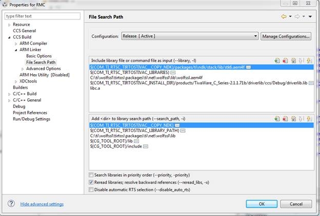

How do I get my project to use my newly built stk6.aem4f which is in copy-ndk_2_25_00_09 instead of ndk_2_25_00_09?
The linker.cmd in my Release keeps pointing to:
C:\ti\tirtos_tivac_2_16_01_14\products\ndk_2_25_00_09\packages\ti\ndk\stack\lib\stk6.aem4f
instead of:
C:\ti\tirtos_tivac_2_16_01_14\products\copy-ndk_2_25_00_09\packages\ti\ndk\stack\lib\stk6.aem4f
I updated the ARM Linker -- File Search Path:
What am I missing?? I don't want to wipe out the original but just point it to the new stk6.aem4f
  • When you hover over the three dots (...) in the first item under the --library option, does it get expanded to the expected directory?
    If you take a closer look at the CCS build console, that should also show you what that path expands to and if the desired library is getting passed to the linker.

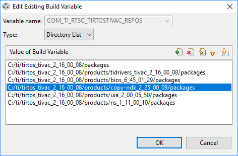

    The linker.cmd is file that is auto-generated by the XDCtools build step and as you can see that file is pulling in several libraries from the NDK (from \ndk_2_25_00_09\packages\ti\ndk sub-folders). If you want it to link in libraries from a different location, you would need to modify the repository path that is passed to the build tools.
    If you look at Project Properties->Build->XDCtools->Package Repositories, you will notice that the paths are passed via the variable ${COM_TI_RTSC_TIRTOSTIVAC_REPOS}. To change the paths you would need to edit this variable. You can do this from Project Properties->Build->Variables tab, enable "Show system variables", then edit COM_TI_RTSC_TIRTOSTIVAC_REPOS to change ndk_2_25_00_09 to copy-ndk_2_25_00_09.
    After doing this, the linker.cmd generated by the build should pull in the libraries from inside the copy-ndk_2_25_00_09 directory path.
    Let us know if this helps.
