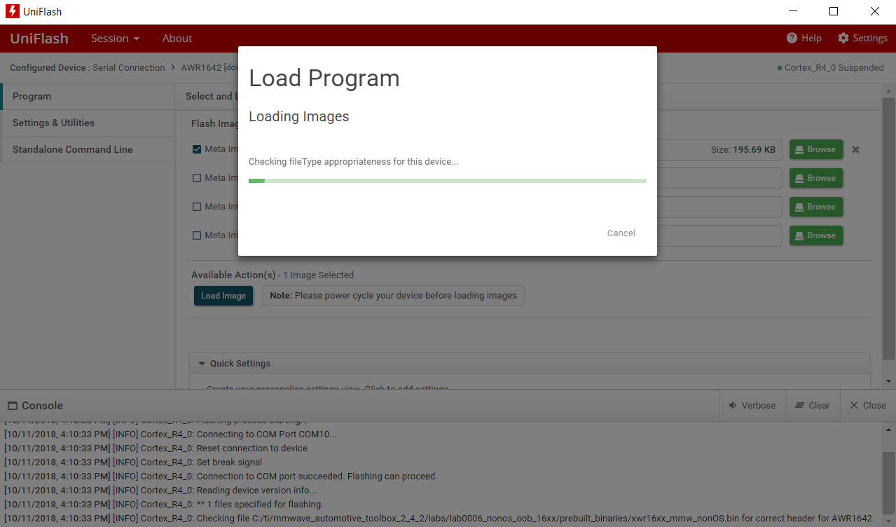

CCS: Uniflash Hangs on Checking Appropriateness...
Other Parts Discussed in Thread: UNIFLASH, AWR1642BOOST
This issue is present with all pre-compiled binaries that I try to upload.

  • Andy,
    Sorry for the lack of details!
    I am using the XDS110 debugger built into the AWR1642BOOST Board (I think that covers your device, board, and probe questions).
    I am using the latest version of uniflash (4.5.0.2046). I should try downgrading because I see 4.4 as the latest on the wiki.
    I am running Windows 10.
    I'm not sure what you mean by example image file? Do you mean one of the pre-compiled binaries?
    Thanks for getting back to me so fast!
    -Conrad

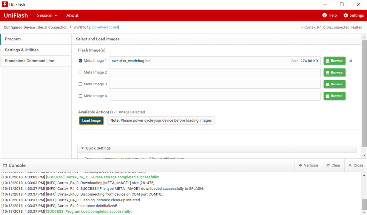

    I've attached the current .bin file that is hanging. They all do hang however. Out of curiosity, I managed to successfully erase the non-os program loaded default on to my board. When I tried re-loading that pre-compiled non-os demo binary it didn't work either. I am trying to upload the CCS debug bin to the board per the driver vital signs developer's guide where you need to flash a binary onto the board so it can be used in debug mode.

  • Downgraded to 4.4 after uninstalling two versions of uniflash. Maybe having two versions installed (but only one running) has something messed up. I don't know what the other version I had installed that wasn't 4.4 was. My issue is now resolved. Hopefully Peter gets his error solved!
