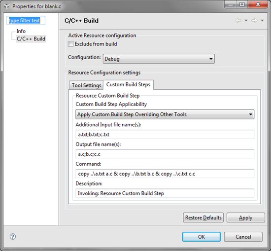

  • Tony,
    I've found another way to handle auto-generated .c files during project-build.  It is less flexible than providing your own makefile-fragments, but you could try it out for your scenario.
    Basically you can use a custom build-step on a dummy .c file to trigger your .c file generation.  And the resulting generated files will automatically be included in the generated makefile.
    I've attached a sample CCSv4.2 project that demonstrates this.  The project simulates generation of three .c files (by copying and renaming three .txt files).  You cannot define a custom build-step on any arbitrary file, it has to be a buildable file, so I've added a dummy .c file (blank.c).  Right-click on the blank.c file to see how the custom build-step is set up:
    You have to know ahead of time the names of all .c files that will be generated, and specify these names in the step (Output file names text-box above).  During the build, a build-rule is automatically generated in the makefile for each of these output file names.
    - Baltasar

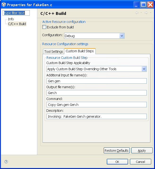

    Failing that, I tried to replicate the method you outlined, but it did not work for me.
    Here is the dialog box for the fake c file I added:
    Here's the relevant part of subdir.mk generated by this:
    Gen.h: ../FakeGen.c ../Gen.gen
        @echo 'Building file: $<'
        @echo 'Invoking:  FakeGen Gen.h generator.'
        Copy Gen.gen Gen.h
        @echo 'Finished building: $<'
        @echo ' '
    However a rebuild does not invoke the custom build as shown in the output:
    **** Build of configuration Debug for project CBTest ****
    C:\Program Files\Texas Instruments\ccsv4\utils\gmake\gmake -k all
    subdir.mk:37: warning: overriding commands for target `Gen.h'
    subdir.mk:30: warning: ignoring old commands for target `Gen.h'
    'Building file: ../main.c'
    'Invoking: Compiler'
    "C:/Program Files/Texas Instruments/ccsv4/tools/compiler/MSP430 Code Generation Tools 3.2.3/bin/cl430" --silicon_version=msp -g --include_path="C:/Program Files/Texas Instruments/ccsv4/msp430/include" --include_path="C:/Program Files/Texas Instruments/ccsv4/tools/compiler/MSP430 Code Generation Tools 3.2.3/include" --diag_warning=225 --printf_support=minimal --preproc_with_compile --preproc_dependency="main.pp"  "../main.c"
    "../main.c", line 1: fatal error: could not open source file "gen.h"
    1 fatal error detected in the compilation of "../main.c".
    Compilation terminated.
    >> Compilation failure
    C:\Program Files\Texas Instruments\ccsv4\utils\gmake\gmake: *** [main.obj] Error 1
    C:\Program Files\Texas Instruments\ccsv4\utils\gmake\gmake: Target `all' not remade because of errors.
    Build complete for project CBTest
    --Mike

  • Mike,
    If you still need to view the project 'test' that i've attached - it has been created with CCSv4.2.0, and you're not able to open it fully probably because you're using an older version of CCS.
    But the main difference between my example and your project is that you're generating a .h file, while my example is meant to generate buildable .c files.  Your Gen.h makefile target is never built because there are no other targets in the makefile that depend on Gen.h.  If all you need is to generate a .h file, you could use a pre-build step on your project.  And to guarantee that your pre-build step always runs, you could add a makefile.targets file to the root of your project and force the main-build target to depend on the pre-build target (see higher up in this forum-thread).
    - Baltasar
  • Baltasar,
    I updated to CCSv4.2.1, but still no luck--same error message.
    Regarding my project, the main.c file includes Gen.h, so Gen.h it does in fact have dependencies that should cause it to be built.
    I tried adding another "fake" c file to generate a .c file instead of a .h file, and that does seem to work, however, I'm not sure how the .h file can be inserted into the dependency graph without even kludgeyer methods which probably not be very reliable.  Is there a way to add another makefile such that it would be triggered by file dependencies rather than simply adding a pre-build step?
    --Mike
