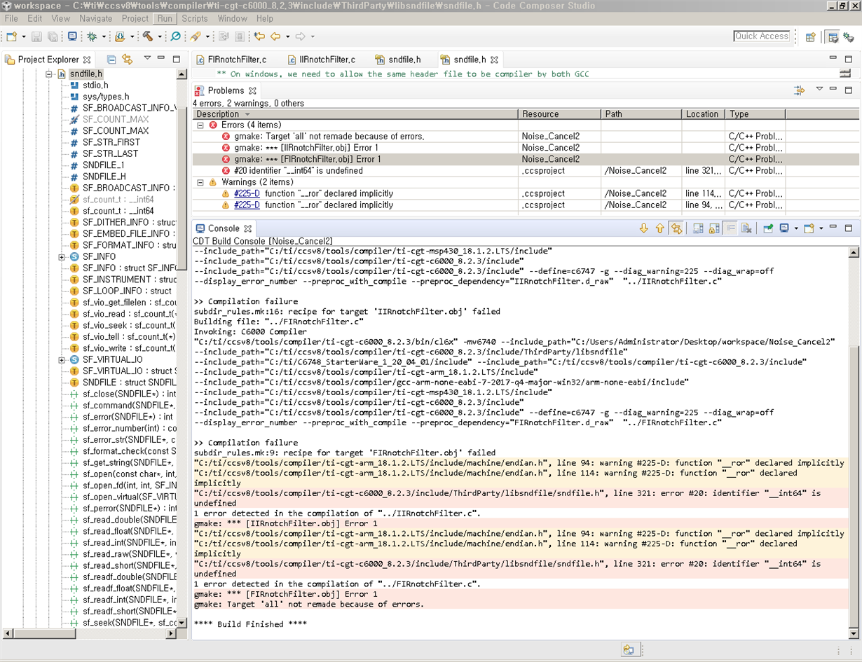

  • Thanks for your comments Mr.Lee.
    Here is my build console.
    I anticipate your answer.
    you have a 3rd party extention to TI's c6000_8.2.3 compiler.
    sndfile.h uses __int64 in line 321.
    There is a chance that __int64 is defined in a header file located somewhere within "ThirdParty" subfolder.
    Just scan all header to find it.
    If not found, go to your 3rd party extention provider.
