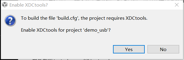

then it showed:
to build the file 'build.cfg',the project requires XDCtools .

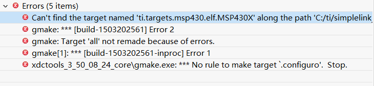

So I enabled XDCtools. But new error showed as :
Can't find the target named 'ti.targets.msp430.elf.MSP430X' along the path 'C:/ti/simplelink_cc32xx_sdk_2_30_00_05/source;C:/ti/simplelink_cc32xx_sdk_2_30_00_05/kernel/tirtos/packages;C:/ti/xdctools_3_50_08_24_core_win32/xdctools_3_50_08_24_core/packages;..;': please check the spelling of the target's name and that it exists along this path.
What should I do?
    I'm not sure what's causing the issue and haven't been able to replicate it. Can you provide detailed steps on how you created the project in CCS? It may be better to import the example projects into CCS workspace.
    Regarding the XDC tools error, the MSP430 does not need XDC tools like the other ARM-based devices mentioned in your second error message. I'm not sure this 'build.cfg' file is necessary . The target configuration files for MSP430 devices ends with extension ".ccxml".

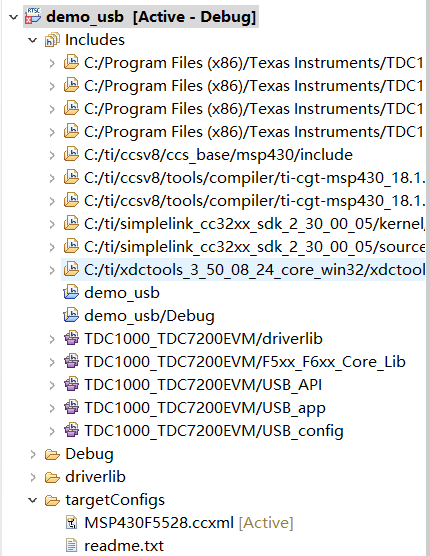

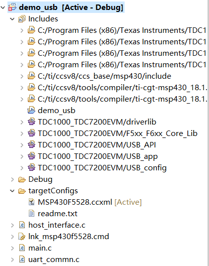

  • Hi James,
    This is the steps on how I create the project:
    1. create a new CCS project
    2.add the files and include the .h files paths :
    3. build the project:
    4. copy the driverlib in MSP430ware:
    5.click YES, the sdk and XDCtools paths are added:
    6. build the project:
    JIAO
  • Today I have replied to your other post.
    Import existing project a start modifying it.
