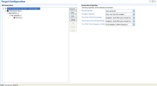

    Please see attached picture showing the target configuration, and let me know if any further information is needed.

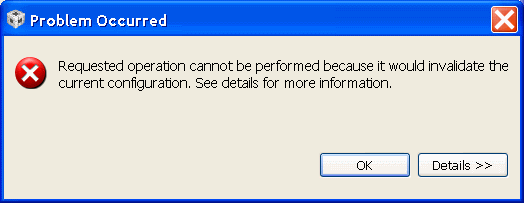

    I could also connect to the DSP, using 4.1, until performing the update to 4.2.  And unfortunately I can't get back to 4.1, since the "Revert to Previous" option is not working.  I've attached a picture of the error received from that as well.

  • Robert,
    You need to use xds100 v1 for this board.

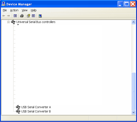

  • Robert,
    The error message -151 means that our scan manager has failed to make a connection to the FTDI chip in the XDS100 hardware.  This can be caused by any of the following conditions:  The USB connection is faulty.  The FTDI chip is non-functional.  The FTDI drivers are not installed.  The FTDI drivers are corrupted.  The VID/PID numbers for the emulator are wrong.  The setup configuration is trying to connect to an XDS100 with a specific serial number that does not match the one in your emulator.
    Given that this board used to work, I think we can focus on two potential causes:
    Either the VID/PID numbers for the emulator are wrong.  Or the FTDI drivers could have been corrupted during the upgrade.
    I recommend you follow the troubleshooting steps at this Wiki site: http://processors.wiki.ti.com/index.php/XDS100.
    Pay attention to information checking that the PC sees the XDS100 hardware, and that the VID/PID numbers are correct.
    Edward
    P.S.: My money would be on the VID/PID being incorrect, still set at the FTDI defaults.  Earlier versions of the scan manager did not check this, but then that meant we would attetmpt to connect to non-XDS100 FTDI devices by mistake.  We fixed that by enforcing connections only to devices with the correct VID/PID.  That could mean an emulator with bad VID/PID used to work but then no longer works after the update.
  • Edward,
    I had noticed that a bit yesterday, and confirmed today, as shown by the bottom 2 entries of USB controllers on my machine (should be TI XDS100 Channel A and Channel B ):

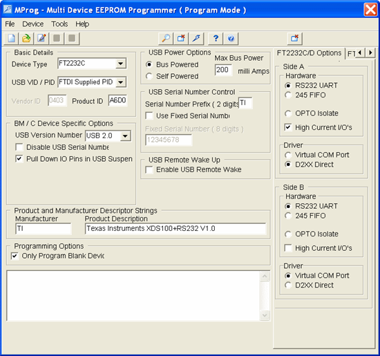

     So I've downloaded Mprog, and the associated .ept file, to reprogram the EEPROM:
    and ran into the following error?
    Robert
  • I've seen that error crop up from time to time even with a good installation and good emulator attached.  Did you try again a few times to see if it'd go away?  If it's constant, then it appears the drivers are corrupted and you'll need to try reinstalling them.  We put the drivers in the ccsv4\common\uscif\ftdi directory.  With the emulator unplugged, you can try right clicking the two .inf files there and choosing the "Install" option (shouldn't matter which first).
    Edward
  • Success :-) (after another attempt at Mprog).  I'm able to connect to target, and run code again.

  • The mostly likely scenario is that the EEPROM had not been programmed at all.  In that case, the FTDI chip uses default values to at least ID itself as an FTDI device. However, given our software at the time wasn't checking, any tests by Logic using our tools wouldn't have caught the problem.
