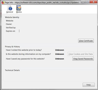

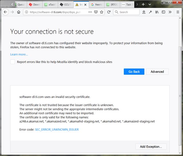

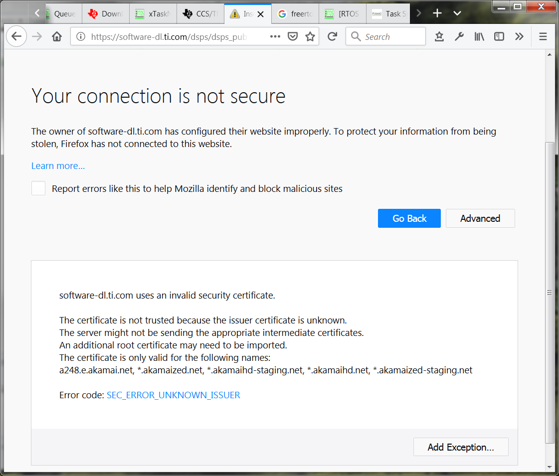

If I'm trying to enter one of errorneous URL in browser I can download corresponding *.jar file. But the error is about certificate: If I try to download files by adding 'https://' at start I got a message about wrong certificate:
software-dl.ti.com uses an invalid security certificate. The certificate is not trusted because the issuer certificate is unknown. The server might not be sending the appropriate intermediate certificates. An additional root certificate may need to be imported. The certificate is only valid for the following names: a248.e.akamai.net, *.akamaized.net, *.akamaihd-staging.net, *.akamaihd.net, *.akamaized-staging.net
software-dl.ti.com/.../com.ti.dvt.analysis.framework_4.1.0.201810091500.jar Peer’s Certificate issuer is not recognized. HTTP Strict Transport Security: false HTTP Public Key Pinning: false Certificate chain: -----BEGIN CERTIFICATE----- MIIEljCCA/+gAwIBAgIQWlNDTDRPI3Xkq6lesBU4rzANBgkqhkiG9w0BAQUFADCB lTELMAkGA1UEBhMCVVMxEzARBgNVBAgTCkNhbGlmb3JuaWExEjAQBgNVBAcTCVN1 bm55dmFsZTE8MDoGA1UEChQzQmFkIFNlcnZlciBDZXJ0aWZpY2F0ZSBbaW52YWxp ZCBzZXJ2ZXIgY2VydGlmaWNhdGVdMR8wHQYDVQQDExZCYWQgU2VydmVyIENlcnRp ZmljYXRlMCAXDTExMDEyNjA3MDgyM1oYDzIyODQxMTExMDcwODIzWjB5MQswCQYD VQQGEwJVUzEWMBQGA1UECBMNTWFzc2FjaHVzZXR0czESMBAGA1UEBxMJQ2FtYnJp ZGdlMSIwIAYDVQQKExlBa2FtYWkgVGVjaG5vbG9naWVzLCBJbmMuMRowGAYDVQQD ExFhMjQ4LmUuYWthbWFpLm5ldDCBnzANBgkqhkiG9w0BAQEFAAOBjQAwgYkCgYEA sD3f7iv3GkEy3vF0Le6CPoIyRN+7Z8ocb//yO5WxgOyatCSh1osQRTQfPdHW9AQL hDxqvAPp3clxb1TNdo3c4c63LyJLqK5jSs7LAKXfveqJ0FXBBSZdEgmIxx23y5ev slHy6B0zKbbcj0k4uIiM/2Z80A7+rG2kf5PUdn5KNUMCAwEAAaOCAf4wggH6MG4G A1UdEQRnMGWCEWEyNDguZS5ha2FtYWkubmV0gg8qLmFrYW1haXplZC5uZXSCFiou YWthbWFpaGQtc3RhZ2luZy5uZXSCDiouYWthbWFpaGQubmV0ghcqLmFrYW1haXpl ZC1zdGFnaW5nLm5ldDAOBgNVHQ8BAf8EBAMCBaAwHQYDVR0lBBYwFAYIKwYBBQUH AwEGCCsGAQUFBwMCMAkGA1UdEwQCMAAwggEEBgorBgEEAdZ5AgQCBIH1BIHyAPAA dgC72d+8H4pxtZOUI5eqkntHOFeVCqtS6BqQlmQ2jh7RhQAAAWEQxl2TAAAEAwBH MEUCIC8rAECRjsgkhiBjpJzl4ja9F86E24I3z+pk8z0F0MsqAiEA5xjdwD+Hr3/L ehQX7rLryM79S3YljOyNfj7Eo+575WEAdgCHdb/nWXz4jEOZX73zbv9WjUdWNv9K tWDBtOr/XqCDDwAAAWEQxl2nAAAEAwBHMEUCIQDSQbEPBYkygDd2jC6PTwFXV9Pz 75yMU7jEmLLCUJzvLgIgeRV/tts6Dr1s8Zo42Tiyk9j/Nja8pyoEjDGsoPUKj3Aw RgYDVR0fBD8wPTA7oDmgN4Y1aHR0cDovL2dhdGV3YXkuenNjYWxlcnR3by5uZXQv enNjYWxlci16c2NybC02NTU4MS5jcmwwDQYJKoZIhvcNAQEFBQADgYEAfGhEwPUK IQjLx6e0/drQCY6XD10laCwqF7fp252QE7l0/4GBB4cCu+Fs2riHucePIXT8muxs ZnFPbQwZDxKxRd2xL9WYkvHLG4defd/6Q3u/vnG7ILe1QXrGFCsTRgNyuSDwpiXL cnjJ7/wCUCtyLJU3ZPQ4/fCE+DJhNaIUbdI= -----END CERTIFICATE-----
