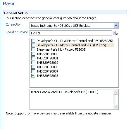

  • Hi, I also have a very similar problem with "High Voltage Motor Control and PFC Developer's Kit" (TMDSHVMTRPFCKIT).
    • I'm using Code Composer Studio Version: 4.2.1.00004 on Win7 (64bit).
    • USB cable works good and double checked jumper and connection.
    • TI XDS100 Channel A, TI XDS100 Channel B are detected normally.
    • Board TMDSHVMTRPFCKIT is new and never been used.
    • Bulding of a simple "Hello Word" .c file works good.
    • Board is supplied.
    When try to connect  target (Alt+C), CCS displays following error:
    "Error connecting to the target:
    Error 0x00001200/-1135
    Error during: OCS, Target,
    Unrecoverable emulation error"

    I've tested JTAG with "dbgjtag" as follow:
    Entering:
    • "C:\Program Files (x86)\Texas Instruments\ccsv4\common\uscif\dbgjtag.exe" -f "C:\Program Files (x86)\Texas Instruments\ccsv4\common\uscif\ccBoard0.dat" -rv -S brokenpath
    dbgjtag says:

  • FYI M Emulator config as per the TI doc

    The link didn't correct the problem.. It appears to be a number of problems that are being hit, includeing updating CCv4
