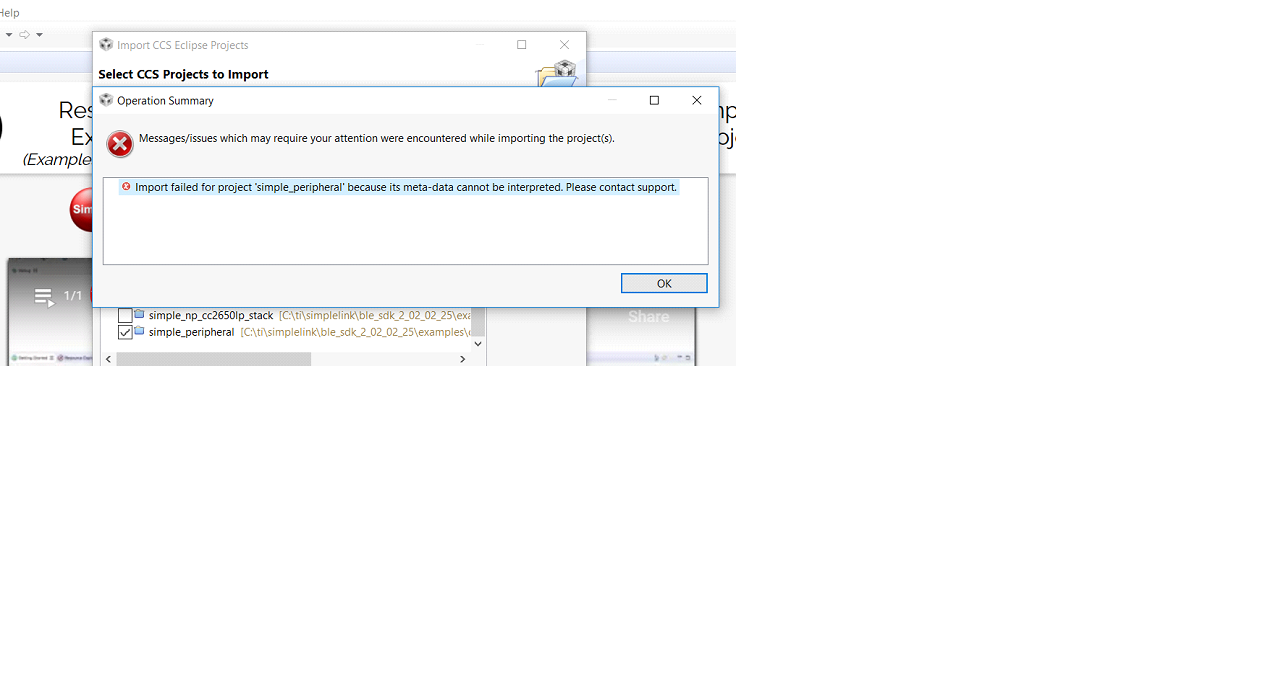

I had been working in project ble_sdk_2_2_2_20\simple_peripheral_lp this week, studying the code, compiling, preparing to test in a launchpad kit.  All was proceeding fairly well.
Today CCS has mutinied!  It not only has completely lost its memory of the project I've been working on all week, but it can't seem to open any project now.  The resource explorer tab only displays documentation, no projects.  I used the getting started - import projects tab and that leads to the error messages shown.
I have no clue how to get out of this mess.  Thanks for helping!
  • Sorry to hear of your troubles. Have you tried opening a new workspace and importing the project again - either from Resource Explorer or Import Project menu? Sometimes the workspace may get corrupted and cause strange issues.
    If you still experience the error in a new workspace, please show us which directory you are navigating to inside the SDK to select the project.
  • OK, clearing things out actually lead to a ccs update. Switched to a new workspace, and was able to re-import.
