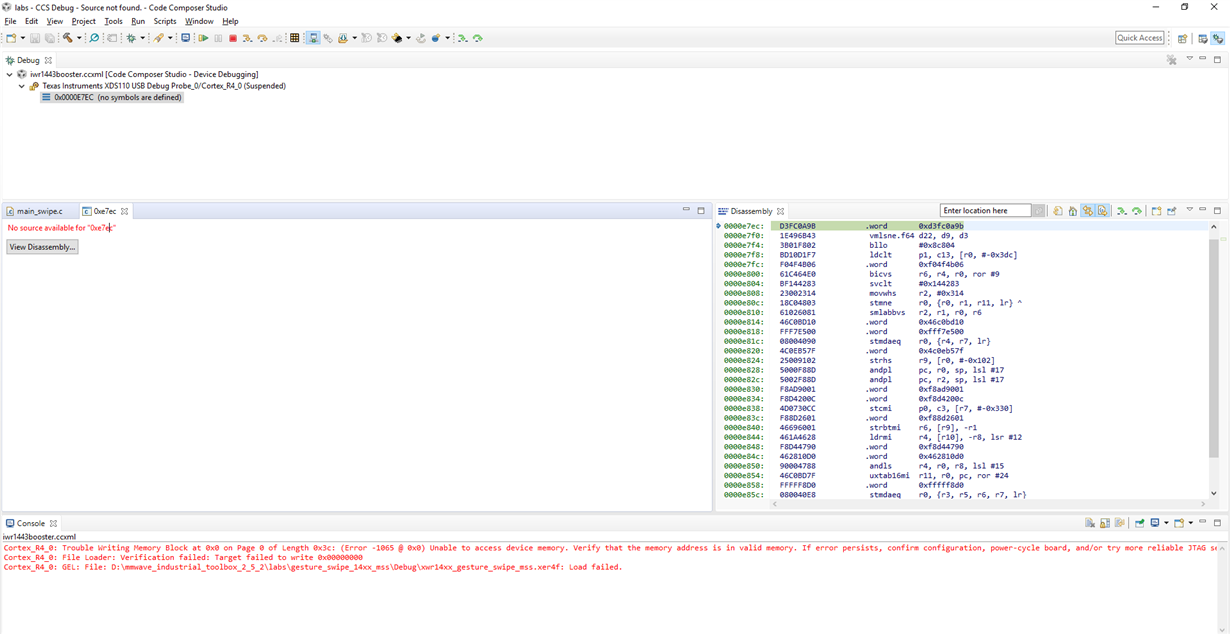

We are getting started with the IWR1443 boost board using lab demo gesture_swipe_14xx_mss. Following the TI training slides, we are able to flash MSS and RADARSS image. However, after that we are trying to upload the application program to the chip, which however shows the memory write error. On the hardware side, the jumpers are put on SOP2 and SOP1 for 'flashing mode'. The error message on CCS says:
Cortex_R4_0: Trouble Writing Memory Block at 0x0 on Page 0 of Length 0x3c: (Error -1065 @ 0x0) Unable to access device memory. Verify that the memory address is in valid memory. If error persists, confirm configuration, power-cycle board, and/or try more reliable JTAG settings (e.g. lower TCLK). (Emulation package 8.0.803.0)
Cortex_R4_0: File Loader: Verification failed: Target failed to write 0x00000000
Cortex_R4_0: GEL: File: D:\mmwave_industrial_toolbox_2_5_2\labs\gesture_swipe_14xx_mss\Debug\xwr14xx_gesture_swipe_mss.xer4f: Load failed.
And following is the screenshot:
