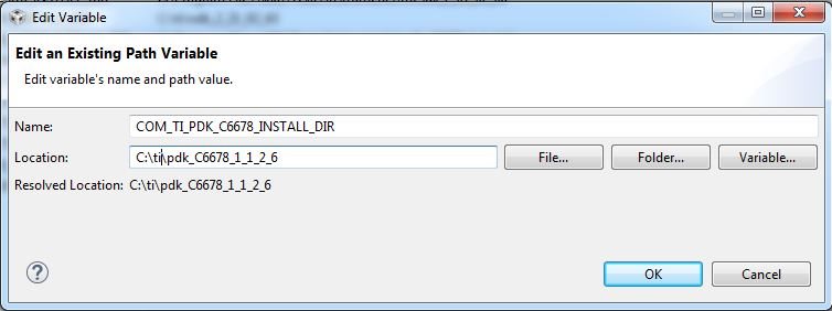

  • Hi
    Sorry for my delay.
    The project is TI client example project as below.
    I want to change the default directory of the variable link in the project properties as below:
    I chose the "Edit" button and the edit variable window appear as below:
    I changed the location directory as below:
    after I pressed the "OK" button the variable path changed as below:
    After I press the "OK" button  and close the project properties the path variable didn't save because I checked it in the project properties and the
    PDK installation directory was the default !!!!
    What should I do? Should I change other things in the IDE?
    BR
  • Please see this related post.
    Rather than changing the variable manually, go into the Project Properties->General->Products tab and select the PDK that is installed into the c:\ti directory. The COM_TI_*_INSTALL_DIR variables are set automatically based on the product enabled in the project properties.
    Let us know if this helps.
