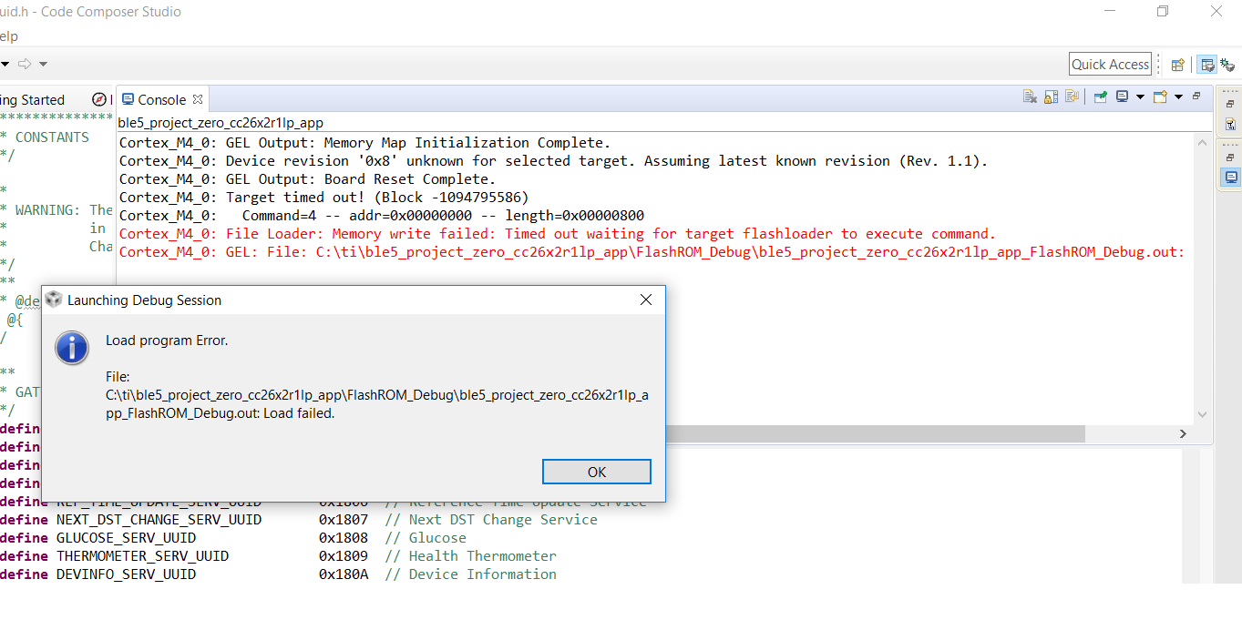

Greetings,
I had a problem and want to check if I'm doing something that is impossible.  My goal is to run your project_zero BLE5 example on a cc2650 launchpad board that we have.
I did this:
(1.) in resource explorer, asked to import a project.  This lead to two new folders being created on disk:  ti/ble5_project_zero_cc26x2rlp_app\... and _stack_library\...  I also noted that a third project was discovered ..._bim_offchip\... with a slightly different path.
(2.)  Built each, no problem.
(3.)  Tried to flash or load and got XDS errors - see enclosed screen shot.  Attempted various board resets and power cycles with no progress.
Should mention - I previously successfully built and flashed simple_peripheral with no issues.  I notice that flash is still resident after the failed project_zero attempts.
Thank you for your ideas.
Belvin
  • Hey Belvin,
    Unfortunately, we don't have project zero support for the CC2650. The project you are loading is meant for the CC26x2 devices. There are critical differences between the two, mainly in the structure of the ROM. For this reason, you are receiving those errors.
    If you have any specific questions, I'd be happy to answer them.
